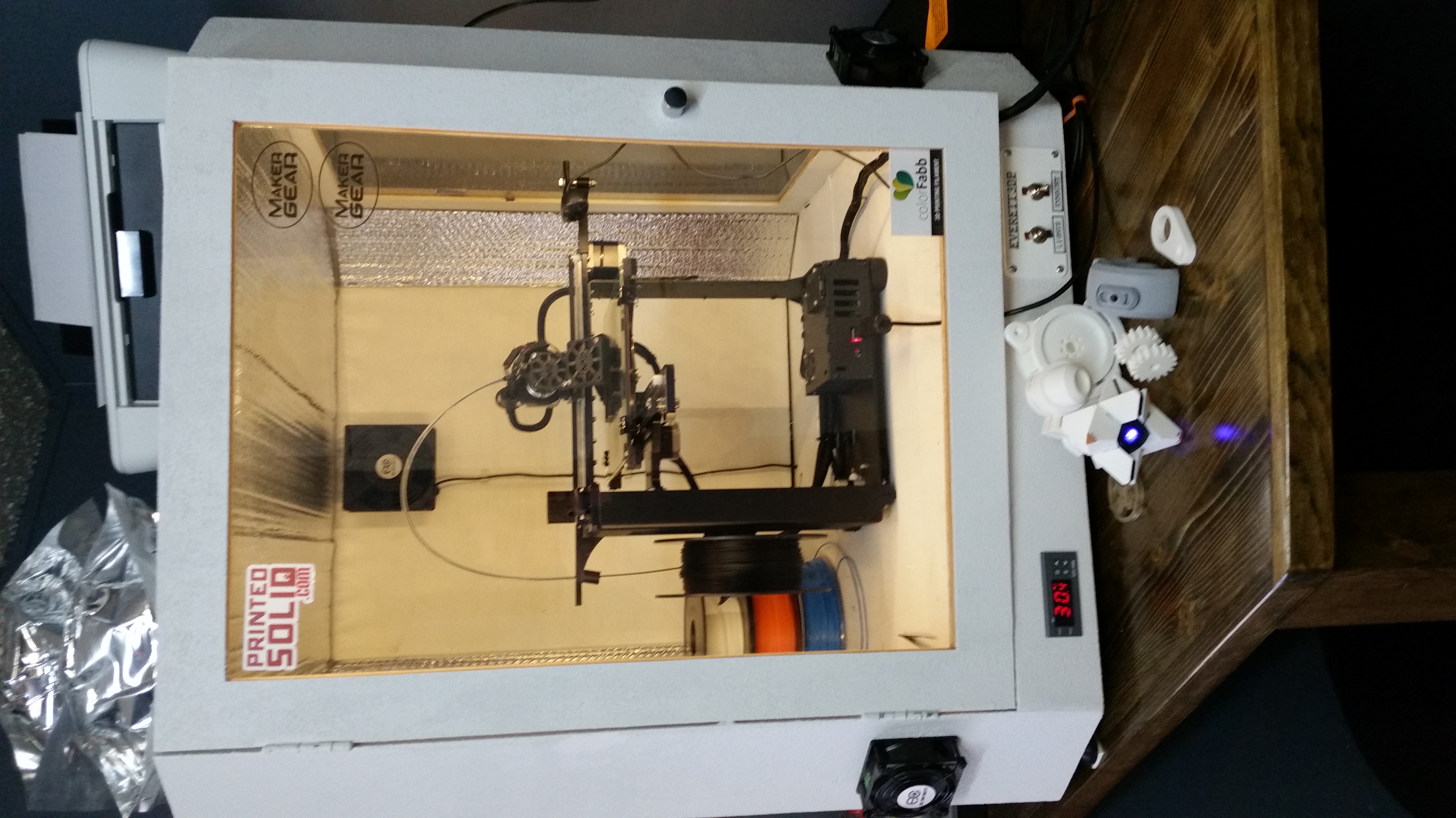

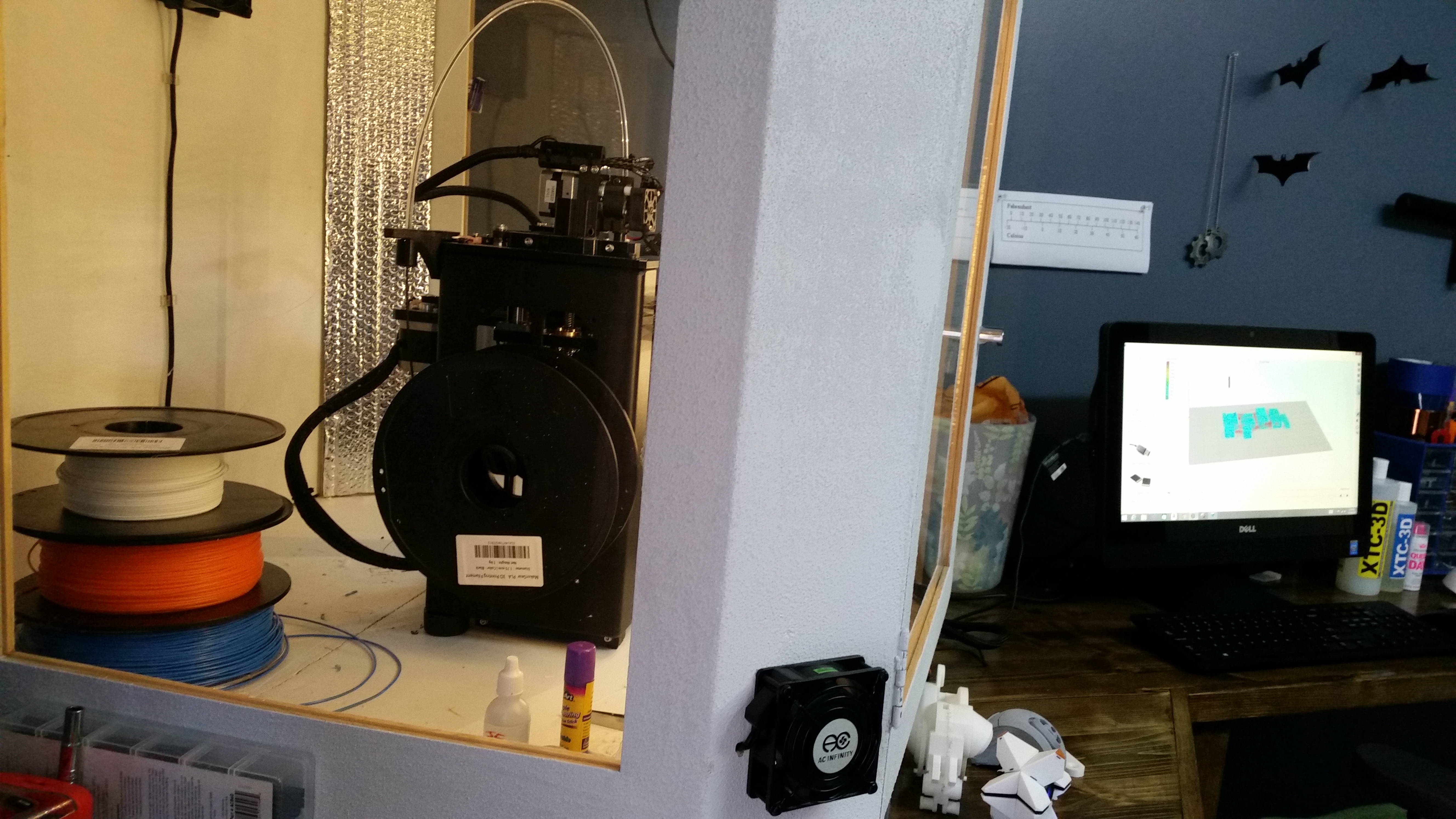

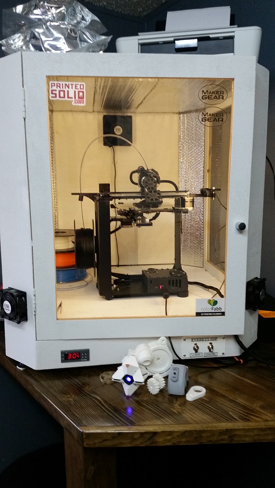

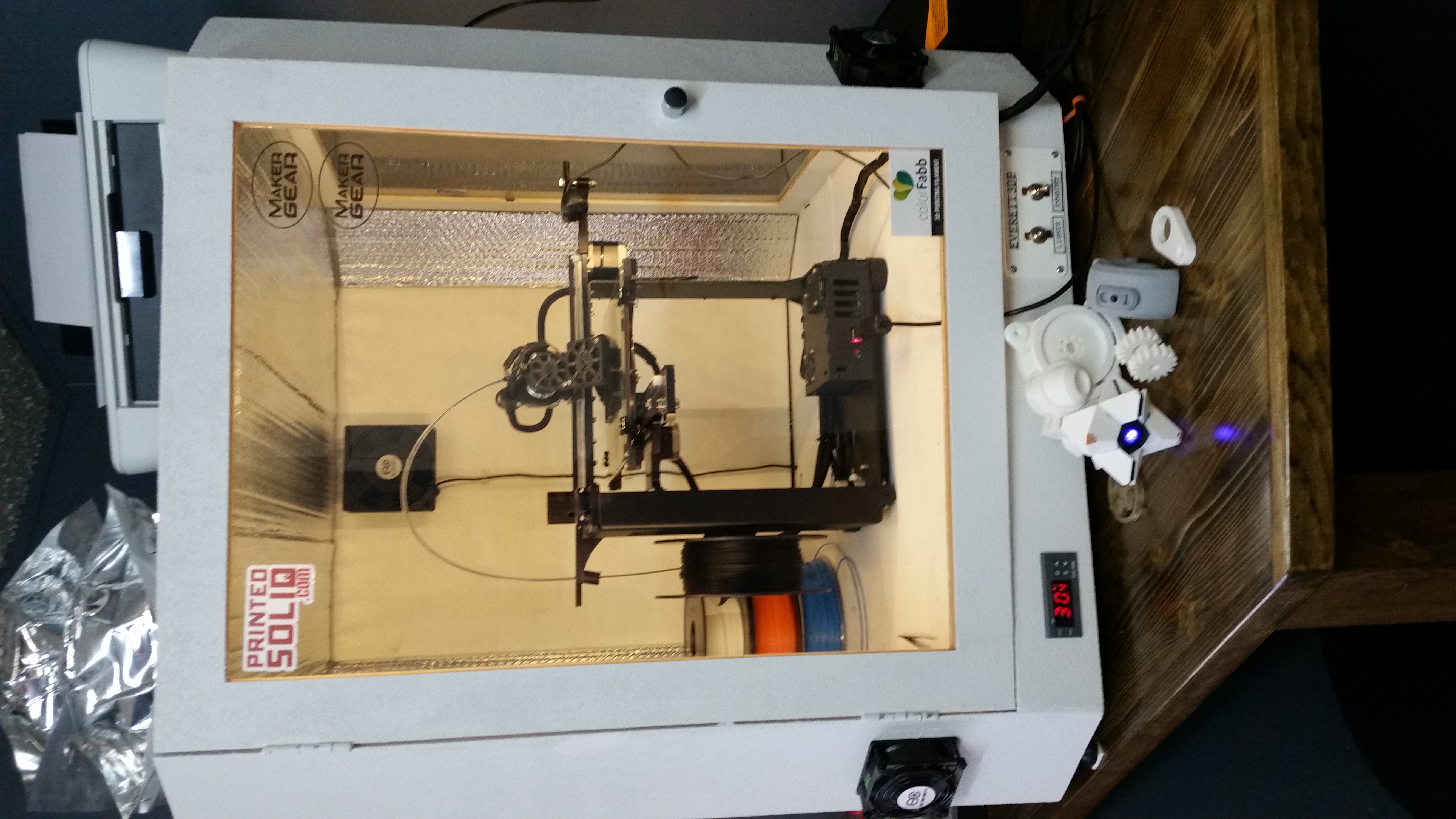

I was having alot of trouble with ABS due to my house always being set pretty cold. So I decided to build my own enclosure for my M2. I searched around and looked at different enclosure just taking away bits from each that I liked. Anyways here is what I have come up with so far. I built it out Of Solid 3/4 Pine and coated the inside and outside with Rubberized paint to seal it in. Then I went over that with a thick Textured white paint. I'm running the STC-1000 Thermostat - Cold is ran by 2 80mm 115V Cooling Box fans. Heat is ran on one Ceramic Disk Heat plate in the Top of the box. There are 2 18" by 24" glass windows and another in the door. I also Have 3 Led bars inside running to a switch and a 120mm 115V Box fan in the back directing Fumes to a window through a 3" exaust tube,also ran one the switch plate. so far all issues have been fixed, ignore the mess as I am still routing the wire and the electronics box for the M2 through the bottom and out of the side of the box. Im happy with how its going so far.

Your enclosure looks great. What temperature are you running it at, and does it help with printing ABS?

Didn't realize just how big they were haha. It has helped alot with ABS, I have only ran it up to 36C but I am scared to go higher until I get the electronics box out and under. But I havent had any warps or splits since on taller models.

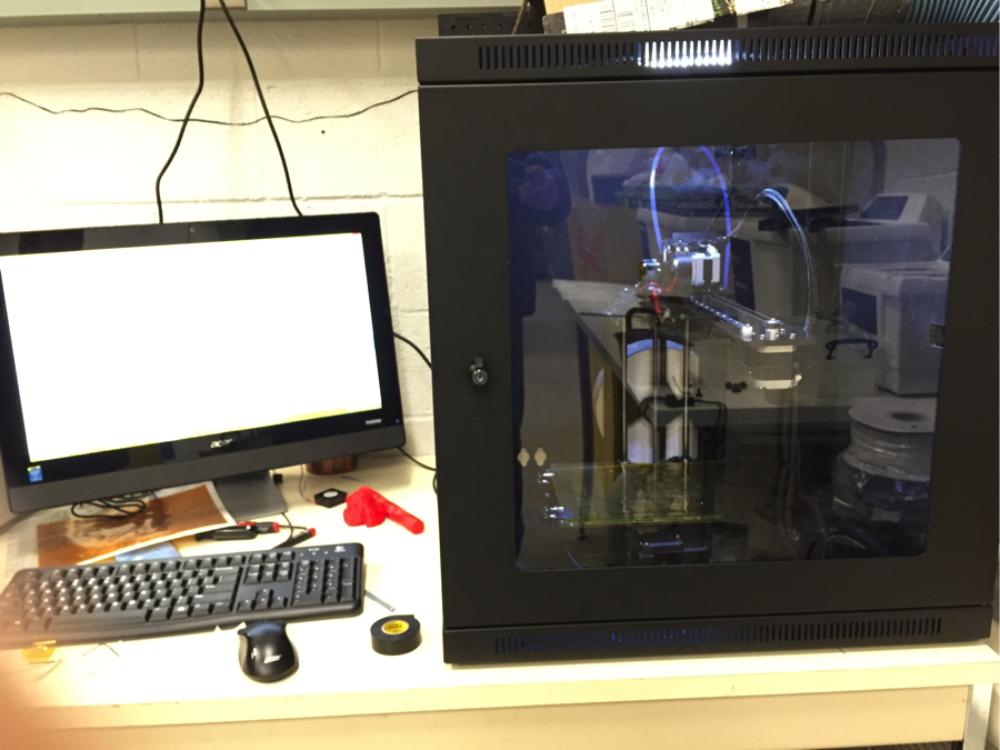

Here's my enclosure... It's actually a wall mounted 19" server rack that I added feet to... It has access panels on the sides and doors on the front and back... I have yet to add a heater, although so far my ABS prints have been pretty good without it...

You've already added the heater-- the M2. The heated platform is a very effective chamber heater that eliminates the need to ever add a separate heater. In fact, it works so well that what you really need to add is a cooling fan to vent off excess heat.uslimey wrote:Here's my enclosure... It's actually a wall mounted 19" server rack that I added feet to... It has access panels on the sides and doors on the front and back... I have yet to add a heater, although so far my ABS prints have been pretty good without it...
