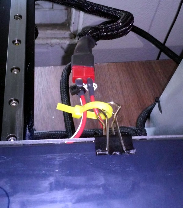

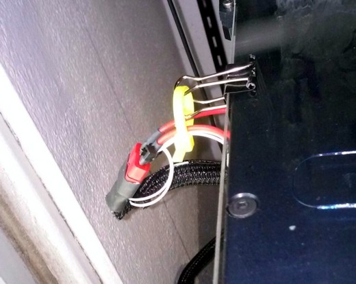

I just did a quick fix that seemed to work out for me.
On the plug I put a stiff piece of heat shrink tubing to take the stress off the solder joint.
On the Heated build platform I loosely zip tied the cable bundle to the plate clamp.
Hope this helps .
It can serve as a quick fix in the field until something new is adopted.
you could use electrical tape if you didn't have the heat shrink tubing.
