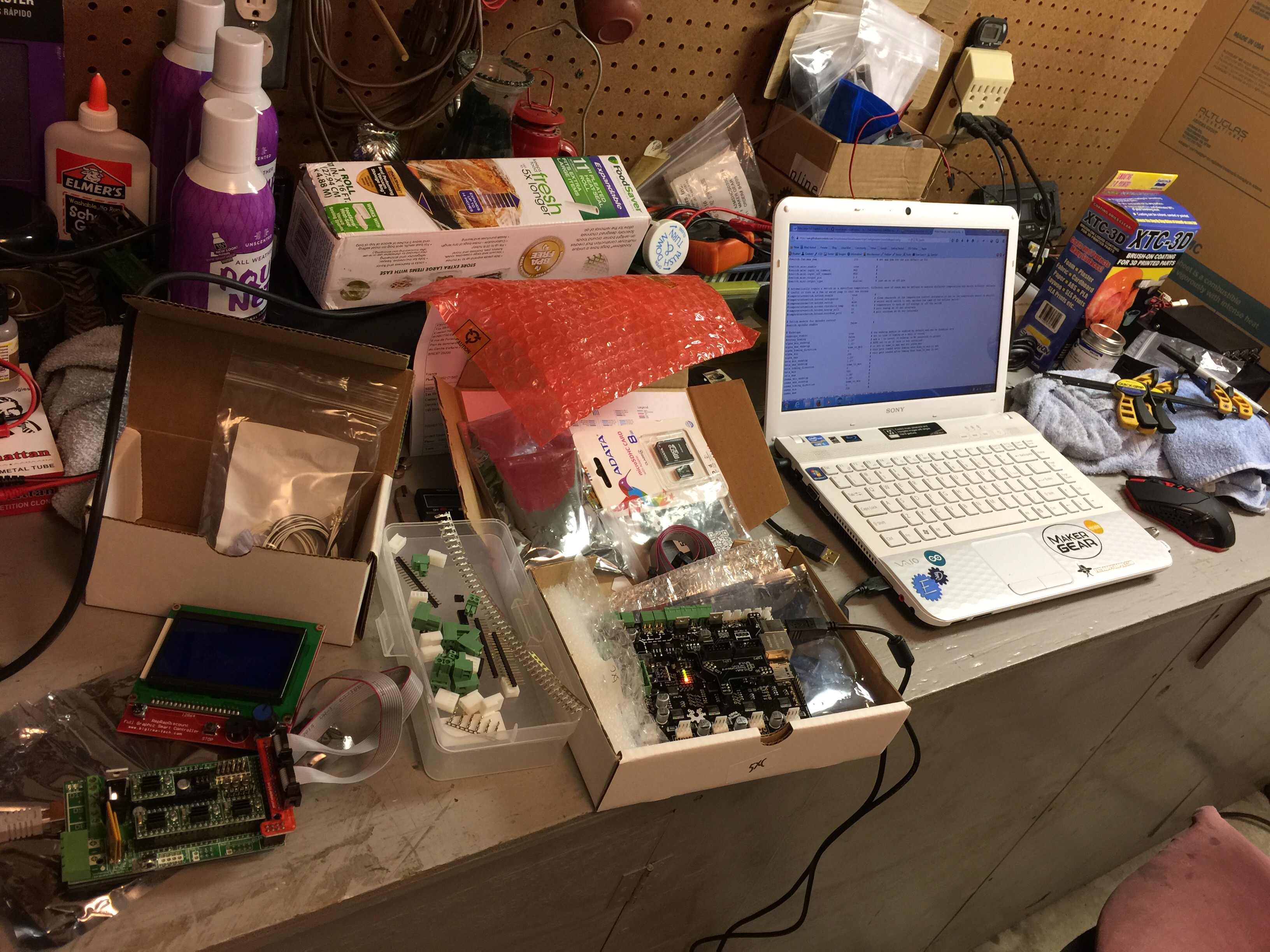

I have been playing with the Smoothieboard a bit and I donfind it much easier than Marlin but then again I was use to Marlin as well, this really just makes it so much easier to make any changes to the firmware.. I also bought some of this stuff called Smooth-On XTC-3D High Performance Epoxy coating.. It's made right here in PA so I got the 1lb. I'm not sure if anyone has used this stuff or not but it sure seems like like it will so a good job..
I about have my inclosure don't for the M2 and I ordered more Plexiglass for makings filament storage compartment above it that will hol 11 spools but I'm only going to use 10 and the 11th bay I'll put one of those rechargeable dehumidifier in..
- My mess right now :)
- (2.01 MiB) Downloaded 383 times
