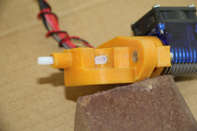

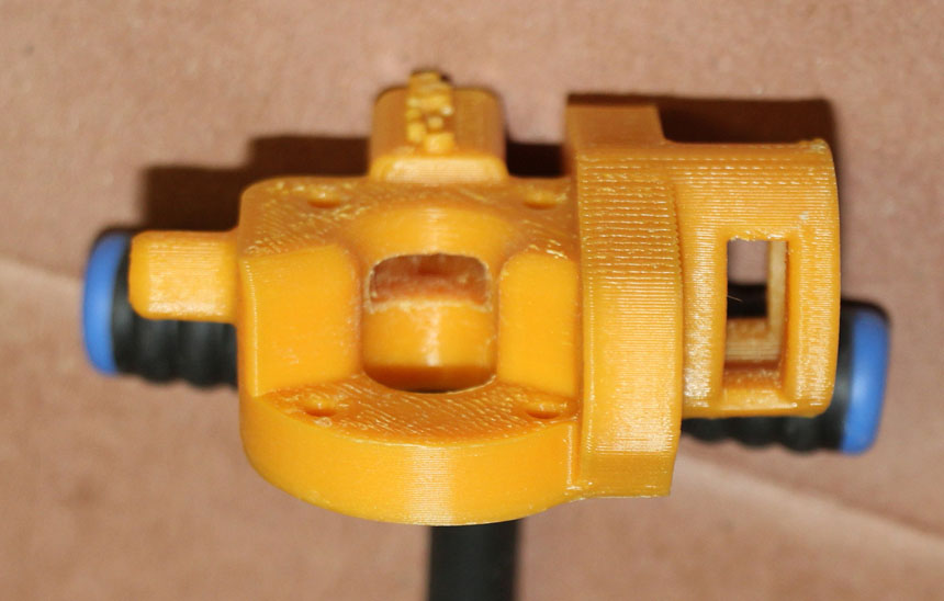

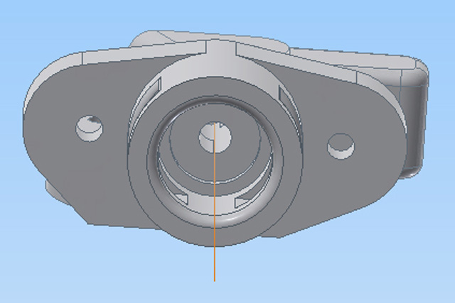

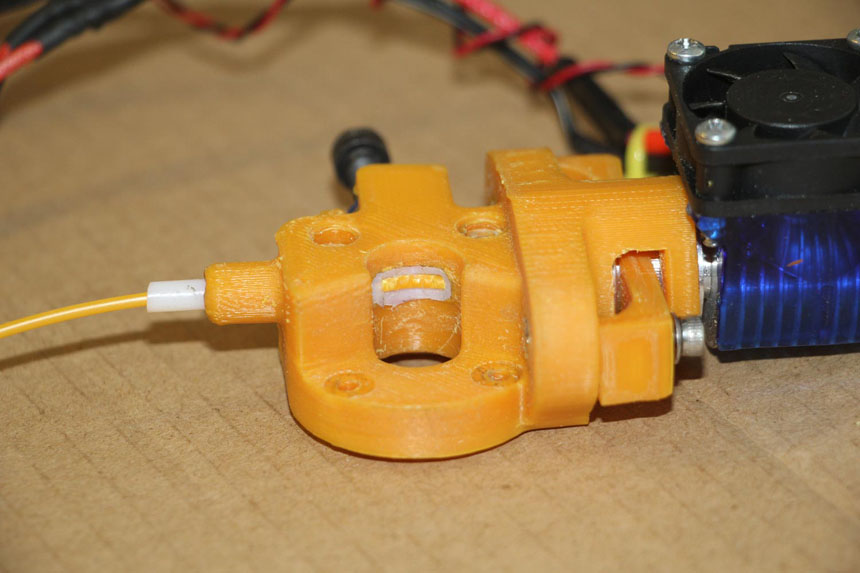

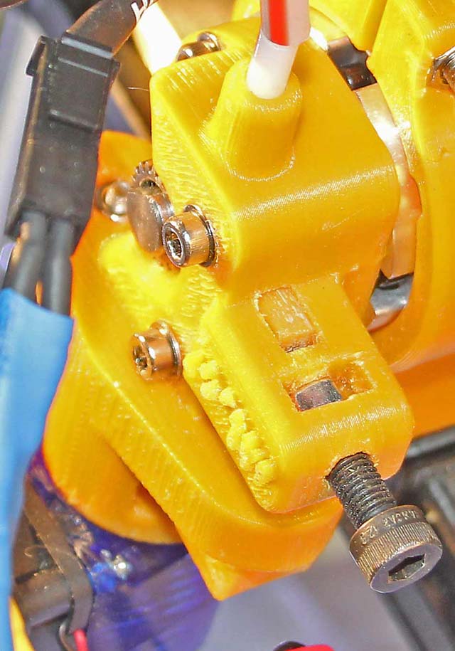

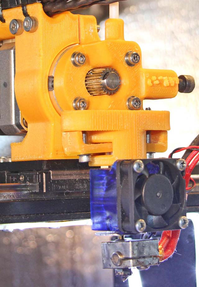

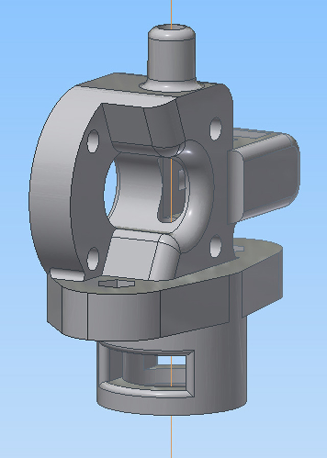

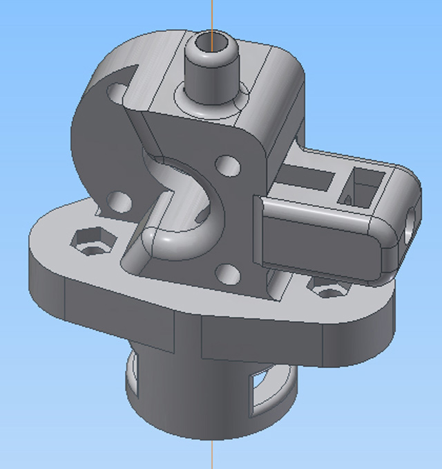

I began this project when I found that the groove mount can become loose affecting print quality. Several months later I now have a more robust filament drive that exceeds my initial goal.
Nine months, 20+ design changes, and 40+ hours of successful test printing resulted in a filament drive with the following attributes:

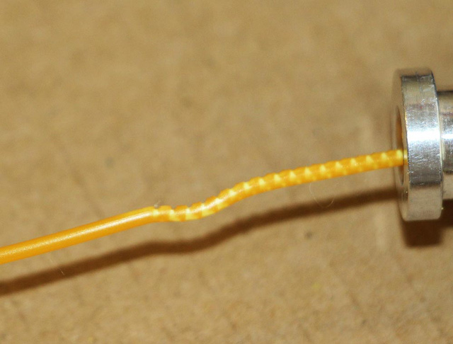

* Reduced/eliminated buckling of limp filament: Low friction and low filament-to-PTFE clearance. PTFE guidance of filament from intake to heat break (E3D V.6), or to PTFE insulator insert in MG groove mount.
* Eliminated/reduced internal wrapping of filament around drive gear:
- Reduced radial clearance between filament drive gear and drive body
- Tailored inlet of PTFE guides the filament as it's pushed from drive chamber.

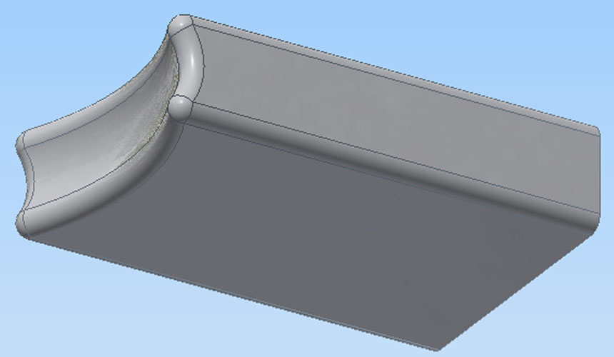

- Form-fitting pressure link replaces bearing.
* More precise control of filament-to-drive gear force: Direct force application via M5 screw and pressure link that are positioned coincident with the center line of the drive gear.
* Probable reduced manufacturing cost and complexity by eliminating bearing and shoulder screw.
* Open drive gear allows monitoring of gear-to-filament engagement. Allows cleaning of gear without removal of filament drive. (At print startup I look for fragments of filament in gear teeth. If present, I clean gear, and increase engagement force with the M5 screw. This has avoided print failures.
* Improved/more efficient ability to service or replace hot end.
I have 40+ trouble-free hours of printing 1.75mm ABS. Looking forward to printing NinjaFlex, Nylon, and other materials.
The present design, although meeting all my performance and serviceability goals, needs to go on a serious diet. I know I can reduce the nose, pressure link, and M5 screw by ~50%. Other ideas would be welcomed.

- 01 Filament-Drive-Vertical-Mount.jpg (95.05 KiB) Viewed 19112 times
- 02 Filament-Drive-Vertical-Mount.jpg (92.15 KiB) Viewed 19112 times
- 03_9465.JPG (82.52 KiB) Viewed 19112 times
- 04_9142.JPG (89.58 KiB) Viewed 19112 times
- 05_9245.JPG (87.73 KiB) Viewed 19112 times

I've been printing with my Vertical Mount Filament Drive on my MakerGear M2 using E3D V6.
I'll post STL files, list of the few parts needed, and instructions, tomorrow (July 7)
Gary
Make Better Things
Make Things Better
Make Better Things
Make Things Better
Re: Vertical Mount Filament Drive
The first photo in my initial post shows that.Lateralg wrote:I've been printing with my Vertical Mount Filament Drive on my MakerGear M2 using E3D V6.

Where does the cooling fan attach on this design?
