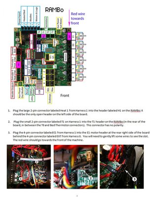

Sure you don't want to get a replacement Rambo? Or maybe check the fuses? (I'd trust MakerGear's instructions over mine.)
This is the correct placement for the plugs. You'll need to change your Tool to Tool 1 everywhere in S3d, and it defaults back to Tool 0, so you'd need to keep on top of it.
That's the limit of what i know - and no guarantees it will work.

Okay, don't know whether this will work or not but it's worth a shot:
On Layer tab - change Extruder Toolhead Index to Tool 1.
In the Jog Controls - change Active Toolhead to Tool 1.
This of course assumes that you have changed the 3 plugs to the receptacles shown above.
If it doesn't work and you have a V3b nozzle, you would have to update to V4 before you could use the dual firmware, at which point it should work.
