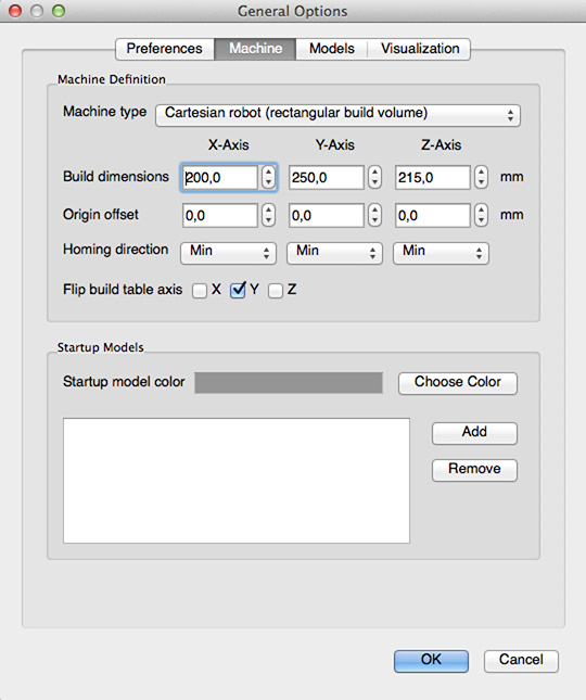

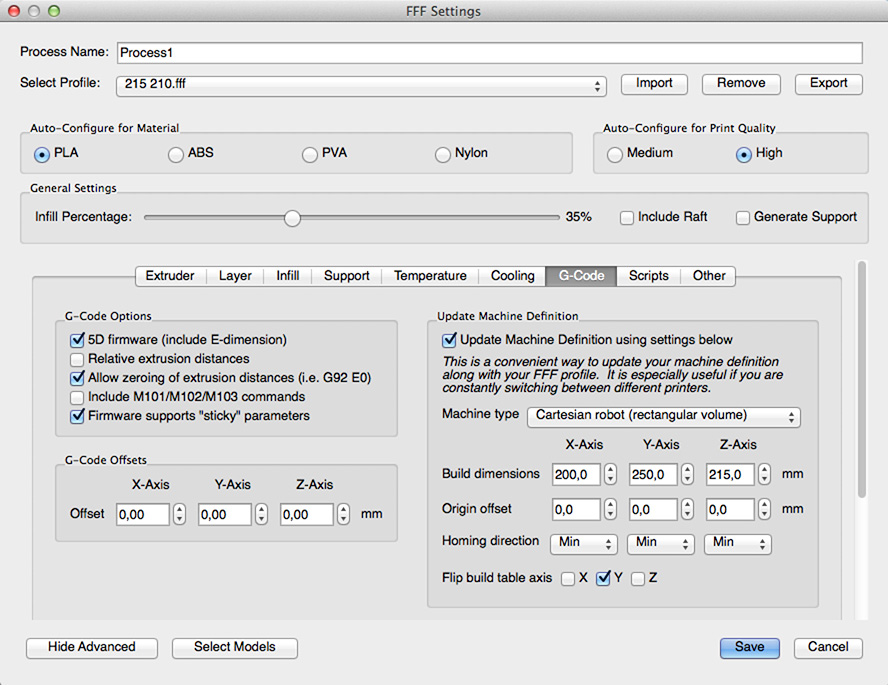

Hello everybody, I slightly modified my M2 to get an extra 15mm on the z-axis. I need this to print shinguards without having to glue parts together. I am using simplify 3D. I changed these settings in the preferences and the process dialog:
Well the printer prints perfectly, and continues to extrude filament after reaching 200mm of height but the z-axis stops moving. x and y continue moving until the end of the print ruining the top layers. How do I get the z-axis to move all the way down? Any ideas?
