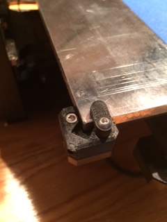

I got the plate installed, and just using the stock clips so far. Just backed the screw out enough to get the clip over the plate, then tightened a bit. Looks a bit odd, but seems to work fine. Z I will print your clips in the am and see how they work.
The new plate STICKS. I have been really frustrated with the printer as I was having issue after issue getting my first layer to stick.
Maybe its the plate (probably), maybe I set the gap better (I used a sheet of printer paper and set it at just some friction) or maybe its a new day, but anyway you slice it, the prints now stick.
I am a happy camper
