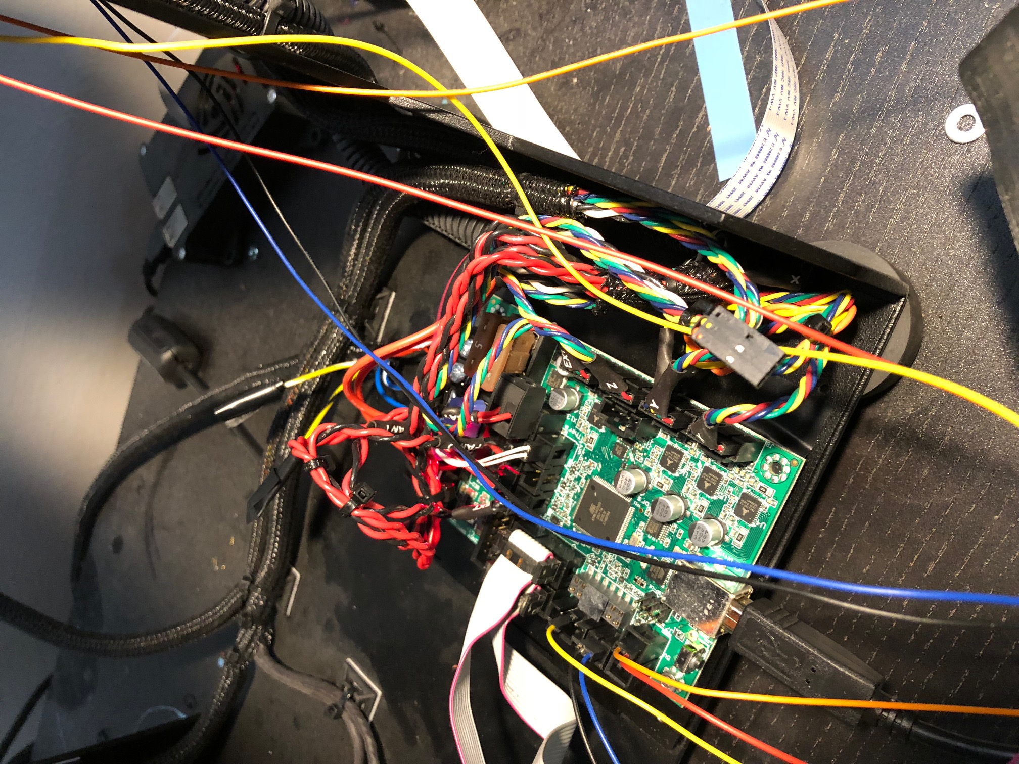

So I brought a "EINSY" board http://reprap.org/wiki/EinsyRambo (the one in the Prusa MK3) since I kinda wanted a Prusa but didn't want to buy a Prusa. I've spent some time with it on my M2E and so far I'm in love with it, I highly recommend this board! Here's my thoughts so far:
Pluses:
Quiet even in speadCycle mode.
Sensorless homing is wonderful.
The Trinamic 2130s seem to produce a better quality print.
Stepper motors run cooler.
Negatives:
All the fan outputs are 5v. This is the apparent reason why Prusa is using the Noctua fans. I have a 40mm Noctua and that one seems to be fine for the extruder, but the 5v that I have for my part cooling seems a little inadequate.
The REPRAP_DISCOUNT_FULL_GRAPHIC_SMART_CONTROLLER I have for the display is a bit garbled, it still works but it's a tad annoying.
Here's a photo of the board wiring is messy at the moment: Sample print but this is with the 5v fan and you can see cooling artifacts in it: Garbled screen: Things left to do / research:
I'll look for a fix for the screen, but I really don't use it that much since I use OctoPi so I may even remove it.
Find a 5v fan that outputs adequate cooling or I may go with a MOSFET solution and use VCC for the fan.
I would highly recommend the MG guys to look into this solution for one of their future printers!

Thanks for sharing! I'm interested in trying this out too. I own a Prusa i3 MK3 (and a handful of other printers) so I know how awesome the Trinamic 2130's are! I am just getting my first Makergear tomorrow (used M2) and I've been thinking about a few mods and upgrades (and I already picked up one of the Einsy boards from Ultimachine). I have to say I'm more than a little excited about the combination of the M2 precision and the Trinamic performance and features.
I was struggling to find good options for fans as well considering the move to 5V, but just today I noticed Prusa's online shop started selling a whole slew of replacement parts. Unfortunately, ordering the fans by themselves will make it expensive as fans go, but I decided to go ahead and go that route since it's so hard to find 5V fans and I know these work fine for the task (and even have a tach in case you want to monitor fan speed). I'm planning to just use the blower for the part fan and design a simple bracket and duct. Then I'll just use the Noctua like you're already using for the hotend cooling, assuming it seems to do the job.
Re: Mini-Rambo "EINSY"
I'm using the the NF-A4X10-FLX 5V for the extruder fan, and Gdstime 5 Volt 50x10mm 50mm for the part cooling fan currently. I've ordered a couple of blower style fans that I'll probably use for the part cooling as the 50x10 doesn't seem to provide enough airflow for PLA cooling.
I did solve the garbled display issue, it was a timer issue that I failed to implement when I was creating the Einsy configuration files in Marlin.
I've got a layer shift on the Y axis on a 4+ hour print (200% Benchy @ 80mm/s) but everything on it looks pretty good surprising with the 5v fan. I'm going to add a little more voltage to the Y driver to see if that fixes this issue. I haven't started actively cooling the drivers so it could be a driver overheating that caused the skip as well. More testing to be done there (it could be an acceleration issue as well).
On a more difficult print the cooling inadequacies are more prevalent. So a blower may be needed to get the cooling needed.
Still tweaking and tuning to be done, but overall I'm really happy with it. I do find it eerily quiet when it's printing, I need to change the fan in the power supply so that it'll be even more quiet. I'll report back more when I've got more prints / tests done.
If I'm reading the RepRap Wiki correctly then you could order the Einsy Retro and it'll have VCC for the fan connectors which would be better for the MG2 without doing any / many modifications.
