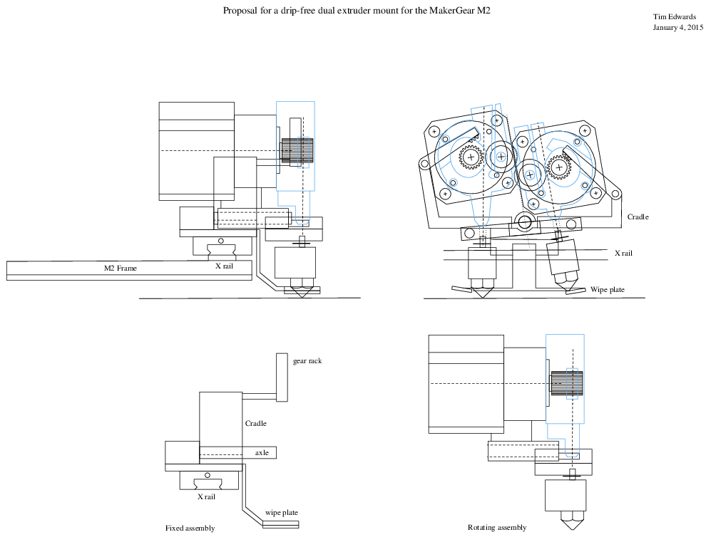

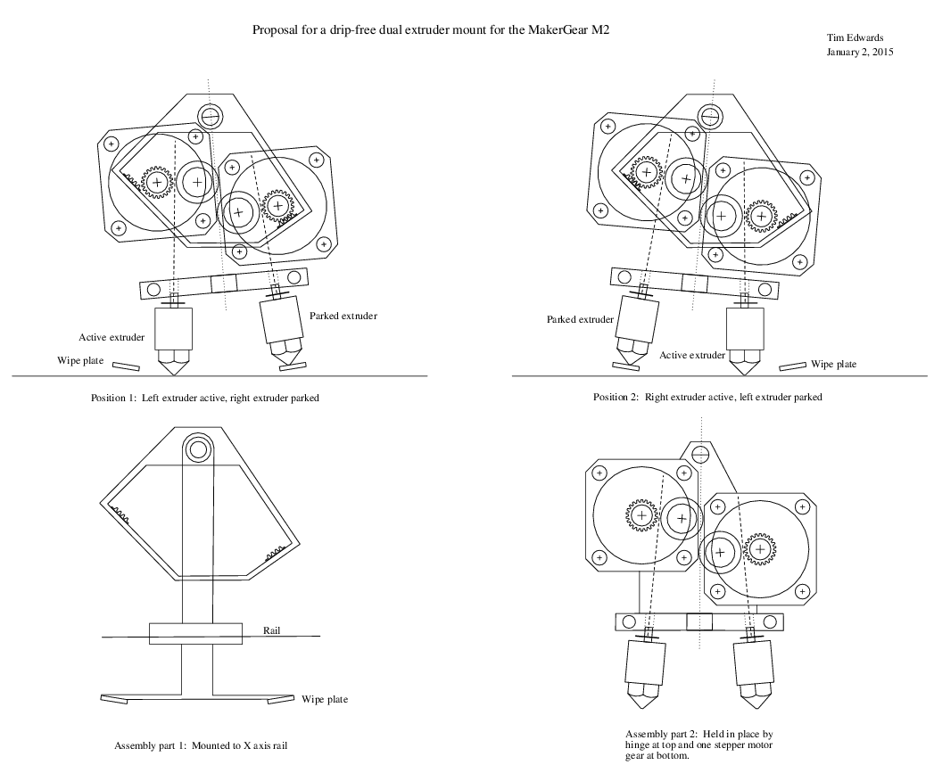

I have an updated picture, attached. From the comments I made in the last post, I realized that I didn't have to move the extruders so far, nor do they have to be in-line with each other, and by reducing the total travel to about 10mm, the gear rack probably doesn't even need to be curved. My new drawing looks very similar to the existing dual extruder setup, except with the motors and extruders not directly attached to the rail, but connected as before through a hinge at the top. There are a lot of little differences, though.
With the extruders only at a 5 degree angle, it could probably be prototyped with the existing hot-end mounting bracket. That would put the nozzles at a slight angle to the plate when printing, but should still work reasonably well.
Dual extruder system, somewhat simplified.

Is there enough power to drive both filament stepper motors at the same time? The thing that makes me nervous about this setup is that you rely on the non-active filament drive stepper motor to be actively braking to keep things in place. In fact I'm guessing that there would need to be a 0 position sensor switch and this mechanism would have to zero out on initialization like the XYZ directions do. I'm also guessing that the Z adjustment procedure would involve loosening/moving away both wipe plates, moving each extruder into position and adjusting it, then parking each and adjusting the wipe plate to match. The person who forgets to move away the wipe plates step probably ends up being unhappy.

I considered that it might require a home position switch for the rotation. If so, it should need only one. The cable assembly that comes with the dual extruder has two unused wire pairs (I'm using one of those pairs for LED lights under the extruder fan, but still have one pair spare), and the RAMBo has additional sockets for switch maximum positions, so it's possible to implement. But it complicates the system by requiring firmware changes, which I'd like to avoid. Another possibility I thought of is that you could allow more room past the gear racks on either side, and as an initialization step, just roll the gear all the way up past the end, let gravity position it against the end of the gear rack, and then roll it back a fixed amount. There might be a mm or so of play in that maneuver, but that's a fixed offset set at the beginning only.
The main thing I'm concerned about with this design is that the position of the gear teeth of the two extruders relative to each other needs to be known exactly so that they both engage the gear racks properly for the short period that they are both engaged at the same time. If not, then you'd have to turn one motor off to let it shift into position relative to the other, but the extruder stepper motors have a high gear ratio and I don't think they will shift that easily.

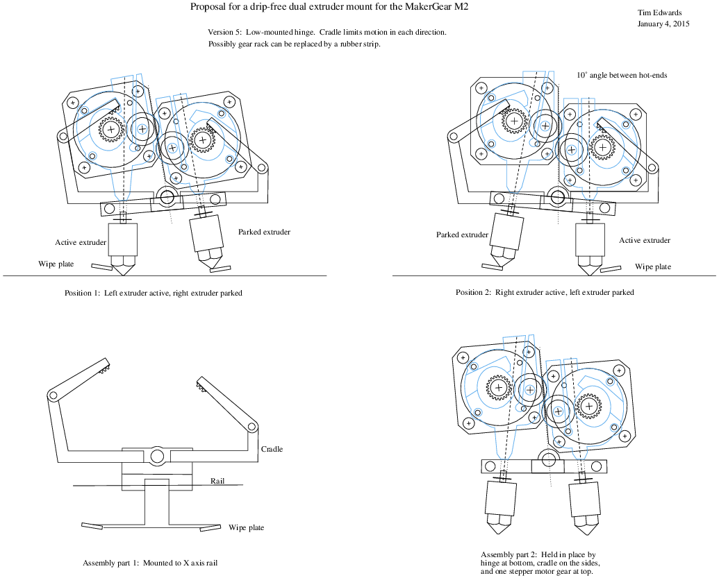

While we're working on this problem I'd LOVE to see part of the solution include automatically sensing and setting the Z home nozzle distance automatically. But of course then I open a can of worms which includes bed leveling and aligning the nozzles to each other, though this turret idea could be combined with Z distance sensing to eliminate the need to the nozzles to be precisely aligned to each other.

Since I just love making drawings of vaporware, here's my latest. This version mounts the hinge low, close to the rail. That puts most of the weight above the hinge, so the motors should naturally want to rest on one side or the other, meaning that the extruder keeping it parked in one position doesn't have to continuously hold it there, but just needs to keep it from getting knocked out of position. Possibly the gear racks can be replaced by rubber strips or something similar, since positional accuracy is not particularly important. This is about as efficient as I think I can make the system, and I have checked various clearances and think everything can fit. Designing all the pieces, of course, is another matter altogether. Like most people, I have to go back to work tomorrow, so this is the last I'm going to be thinking about it for a while.
Dual extruder system, low-mounted hinge
Side and front views
