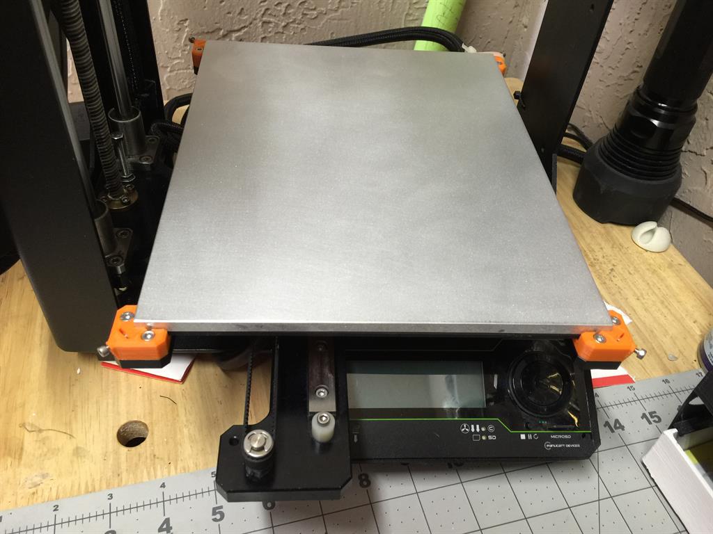

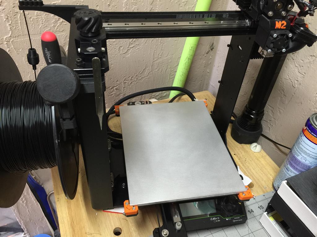

Post by jdacal » Mon Mar 30, 2015 9:05 pm
Hi Jim, received the two plates today. Haven't used them yet but the fit was exact! Didn't even have to adjust the corner brackets. The finish looks great. Thanks, great job!

Post by insta » Mon Mar 30, 2015 9:45 pm
That is a beefy beefcake of a piece of beefluminum.
Beef.
Re: Mic 6 tooling plate
Post by jimc » Mon Mar 30, 2015 9:57 pm
yeah its 1/4". thats the thinnest you can get mic6. i guess because its a milled finish tooling plate.
jdacal, thats great. hope you like how it works. its really nice not having to use binder clips
