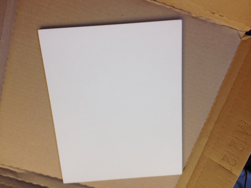

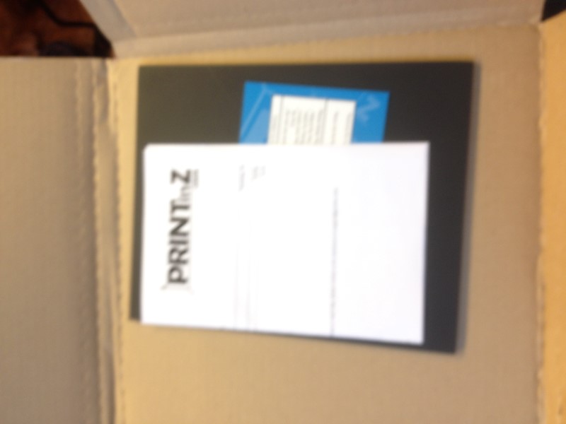

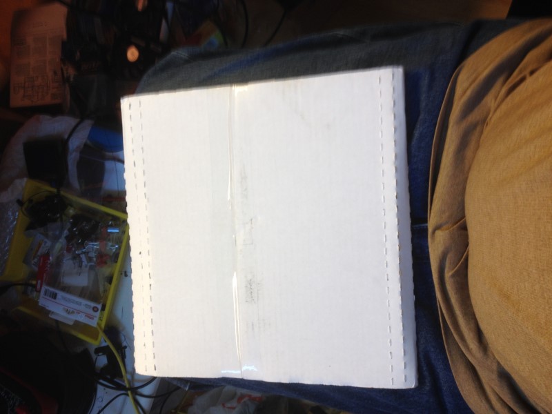

unboxing.

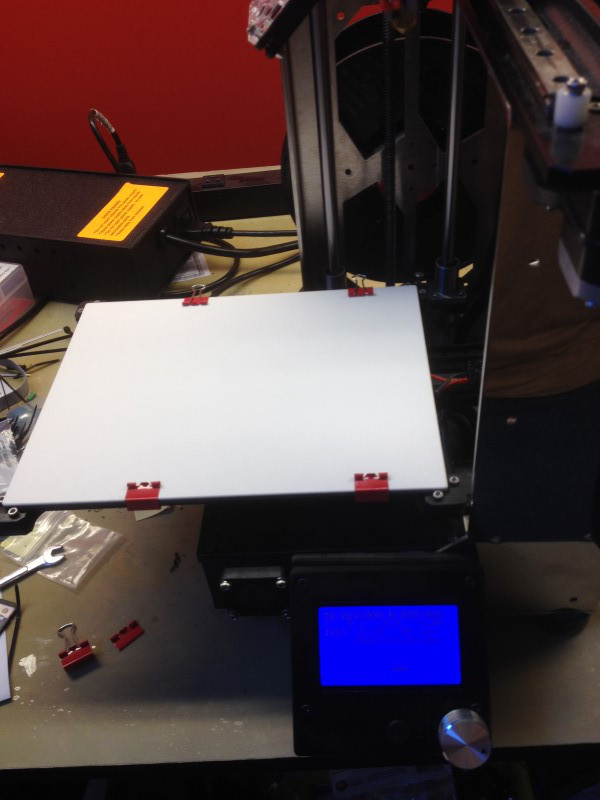

installed

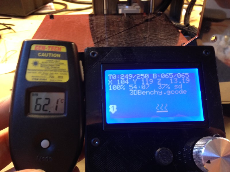

Post by innkeeper » Tue Jul 14, 2015 2:00 am
temperature difference bed vs hbp
IMG_0346 (Custom).JPG (100.19 KiB) Viewed 16630 times

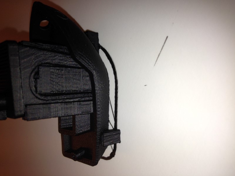

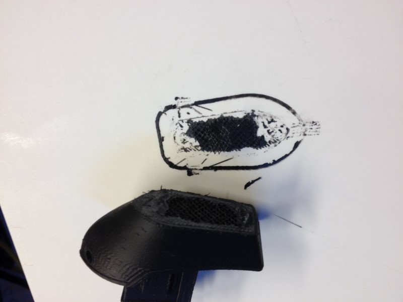

first abs print at the above temp - no warping.. it stuck to the plate very well
IMG_0372 (Custom).JPG (62.48 KiB) Viewed 16630 times
VERY VERY WELL
IMG_0377 (Custom).JPG (55.65 KiB) Viewed 16630 times

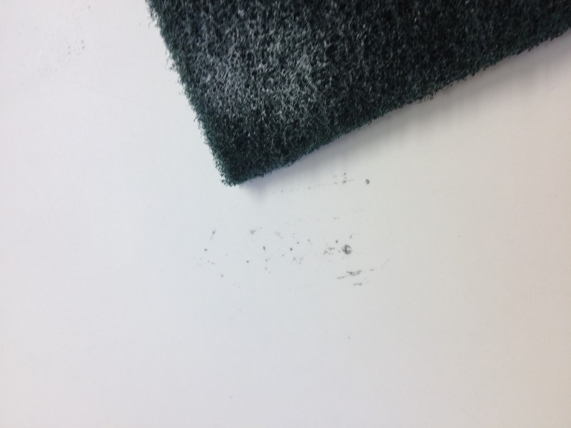

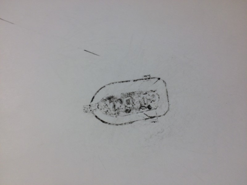

cant use acetone, they say scrape and sand the stuck print off.
IMG_0378 (Custom).JPG (47.26 KiB) Viewed 16630 times
IMG_0379 (Custom).JPG (58.28 KiB) Viewed 16630 times
next time i''ll stick to a surface temp of 50 as recommended for abs...

(To get the last of the gunk off the plate - pick up a Magic Eraser at the grocery store next time you go. It's a micro-abrasive melamine sponge, and the little things are absolute miracles when slightly dampened.)
