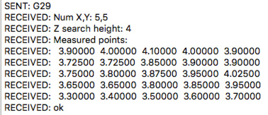

Here is what you want to see G29 give you with a 5x5 mesh leveling grid.
Yes, this Mic6 bed is super flat. The frame however is made from EMT, with printed parts rolling on skateboard bearings, on a plywood base. It is rigid in general, but not precise the way a linear rail is, but the imperfections are repeatable!
The top left number is the X0 Y0 Z-offset (front left bed corner). The bottom right number is the X600 Y440 (back right bed corner) .
That back left corner is crazy off. There is .8mm difference from highest to lowest point.
MESH_BED_LEVEL don't care! :twisted:
