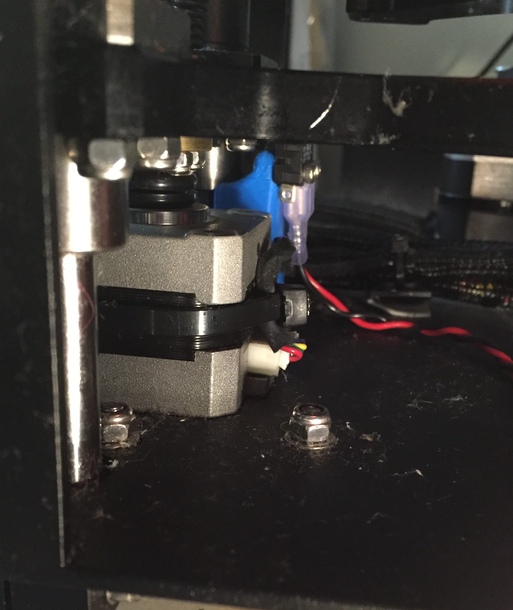

A design comment....
I don't like the idea of the Z stage resting on the limit switch when the printer is not in use. Long term I believe you'll damage the limit switch. My printer has a rubber grommet on the z screw which has been a landing pad for the stage. In installing this new switch, I've positioned it low enough that the grommet takes the full weight of the stage and not the limit switch.
