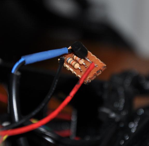

Three components; that's all.
I had a piece of perfboard lying around, so I cut it down to this tiny size, which is all that's needed to accomodate the NPN transistor and two resistors that bias the NPN base. For the circuit, see viewtopic.php?f=13&t=2610&hilit=smoothieboard&start=10. You can see the black and blue wires coming in from the sensor (I put a bit of shrink tubing around them to keep things tidier), and the red and other black wire go to ZMIN and GND, respectivly, of the Z-min connector on the controller board. The sensor's brown wire ties directly to 24V on the controller board power input.

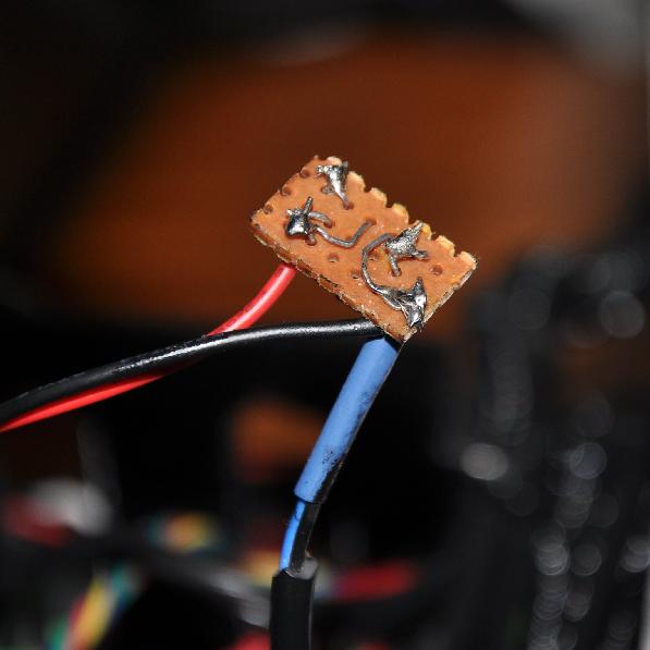

Backside: quick and dirty solder job.
Not the prettiest soldering job, but everything is connected together with the component leads and the wire ends.

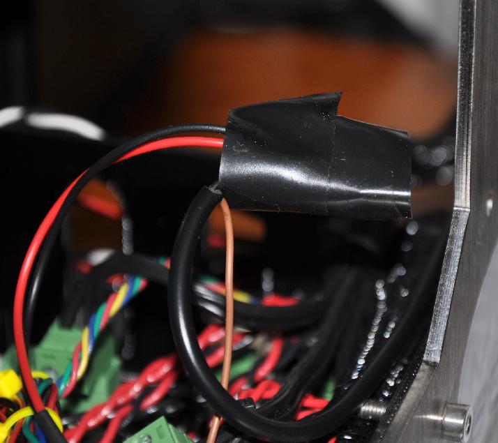

Wrapped in electrical tape and ready to go.
There's that brown wire, going back to the controller board. I just wrapped the thing in black electrical tape and stuffed it back under the hood, and called it done.
I should be very, very careful to point out that the sensor I have is an LJ12A3-4-Z/BY, not a BX. The BX is a bit easier to work with. There is an internal 10K pullup resistor between the output and the positive voltage supply, so you can use this internal component in place of one of the resistors, and scale the other resistor accordingly. Otherwise, you can use the same switching circuit, but it will work non-inverted, and the Z-min should be specified as non-inverting in the firmware.
