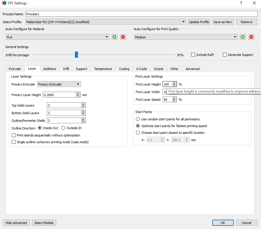

OMG you just saved me from so much frustration I've had over the last few days... I have this one print I run that needs to be a little more squished into the bed for the first layer (which I use to do by just adjusting the z bolt a tad but is no longer an option) I tried just manually editing the z-offset in the g-code to do this but for some reason no matter what I change the offset number too it doesn't do anything. I can change that settings in S3D and it works but the newest version of S3D slices the model totally different than the older versions so one area on top of my supports prints at a different angle now that is just not working for me. With your trick with the jog buttons I should still be able to run my old file. (least I hope)jimc wrote:to add something to my previous statement....i do feel like a bit of a dumb ass. i have been using s3d for i think 3 years now and i just realized the i could hit the jog controls for +-z at .01 on the fly to adjust that first layer while the printer is printing. for some reason i never tried it because it just wasnt part of my workflow i guess and i just figured while printing s3d would lock those out.....guess not. well atleast now if i change a nozzle and the gap is wrong i can change it on the fly without a restart until i get a chance to run the app and reset the gap. i used to just give the knob 1 click but many times 1 click on that can be too big a jump.

You could also increase the first layer height to make it thicker. Where were you changing the z height in s3d. It has worked for me in the past when needed.

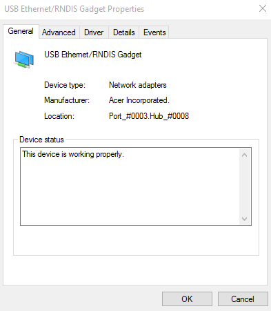

Finally tried to run the makergear software with the fasbot with no luck. It seems to connect by I.P. over usb. I also could not make the bottom switch work so I used it in the standard top position and used octoprint to jog and level. I am very happy with the new setup. It came at just the right time too as my probe died and had to drop auto tramming !!! It makes the leveling process much easier. I can say with all honesty this is the first time in two years my bed has been leveled correctly. It is scary close to perfect. Thanks for the continued hard work on a already great machine !!! One question I had was I see some people posted just turning the leveling screws. I loosened the set screws first then adjusted and relocked the set screws. Do the set screws have rubber in the hole hard plastic or something else to protect the threads ? Or did I assume correctly and loosen them ? If they do lock directly to the adjustment screws I would recommend adding the buffer or changing the directions so they get loosened first !
