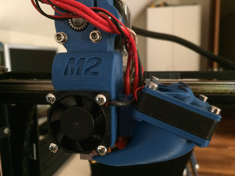

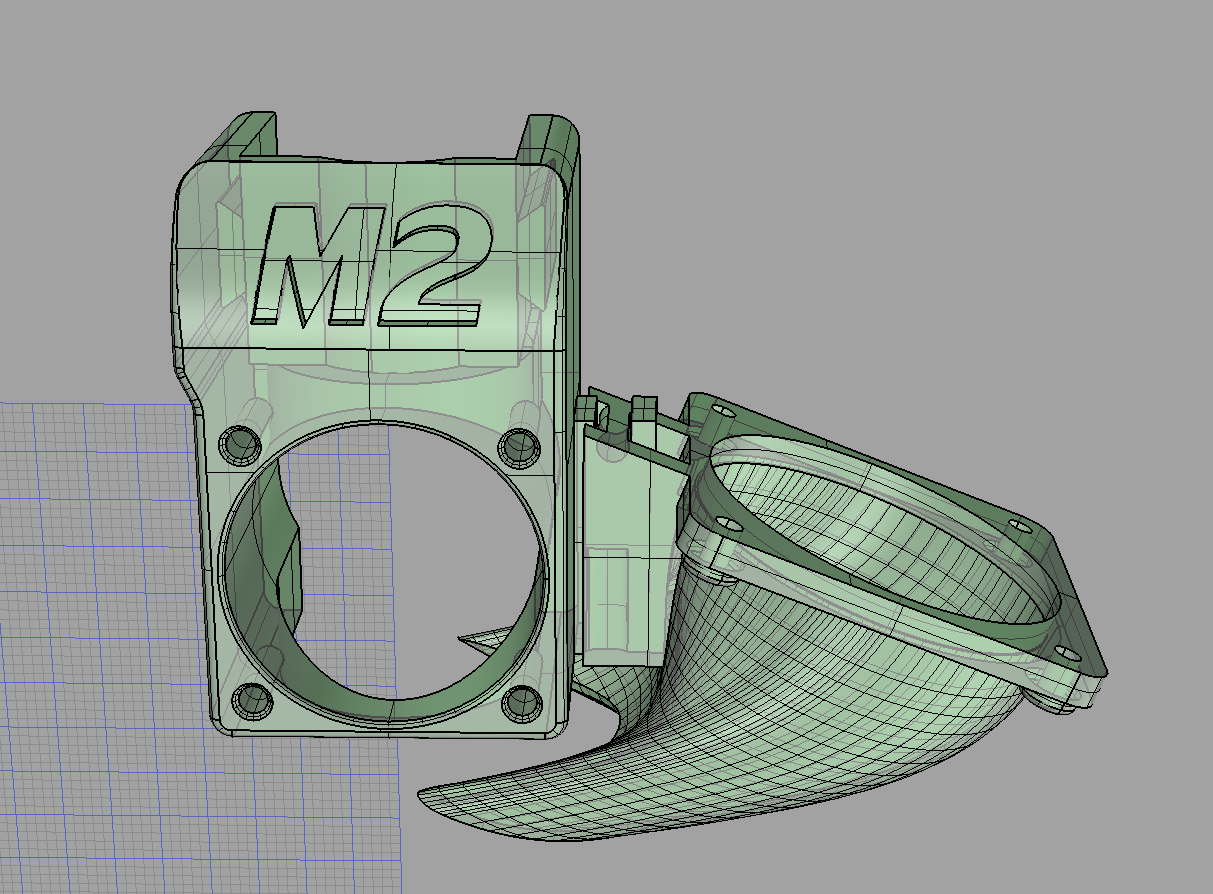

i have the bed fan duct done. im just doing a print now to check tolerances to make sure it doesnt snap into place too hard or too easy. i put a ghosted pic below so you can see how its mounted. basically a hinge pin catches in the top hook then you just rotate it down and it snaps into place. for those of you that do alot of abs you wont need to keep the fan on the machine. just pop it in place when you need it for pla. ill get this posted up on thingiverse later tonight. i have the setup done for both v5 and v6. the duct will use the 40mm fan.

Post by jimc » Sat Jun 07, 2014 8:00 pm
the hinge fitment came out perfect with just a nice gentle force to snap the duct on and off. i uploaded the files to thingiverse

That's really nice, Jim. But no hurry---the E3Dv6 I ordered just shipped.
By the way, that fan connects on the side? Does it do that without restricting the X axis maximum position? Or does that fan go in front with the extruder fan on the side?
Re: E3D V6
Post by jimc » Sat Jun 07, 2014 11:20 pm
hey tim, the fan is on the right side. there is nothing on the right for it to hit. that side is wide open. i just got it all mounted up on my machine.
