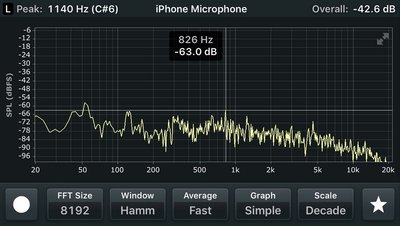

Here is the 50mm fan with no guard. Noise is more or less the same without the guard as it is with the new guard.
50mm bed fan, no guard

What app are you using for the measurements?
quaver
Posts: 51
Joined: Fri Feb 27, 2015 4:32 am
Re: Bed Fan Duct
Post by quaver » Fri Nov 04, 2016 1:00 am
It's a app called "FFT Plot" from the Apple's App Store. Uses the iPhone's built-in microphone or you can plug in an external microphone if you desire. I am running it on an iPhone 5S. I have used this app on an iPad with a high fidelity microphone in the lab at the office and compared results to those taken with a high-end spectrum analyzer and the correlation is very good. Of coarse you must pay attention to distance from the sound source, objects around the sound source, orientation of the phone, etc. when making comparative measurements. These can be reasonably managed but not perfectly. If I repeated the measurements 10 times there would be some degree of variation in the values measured but I think the general relationships would remain consistent.

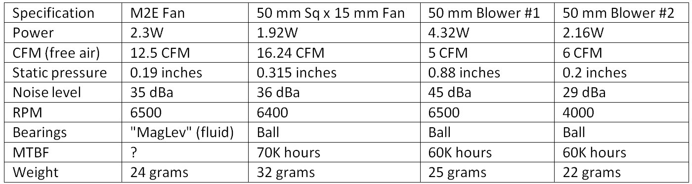

The critical specs are tabulated below. I had to assume that the original fan specs are the same as the lower power version:
The battle is largely between the middle pair. The quieter blower can handle only slightly better back pressure than the original fan, at half the CFM.
The 15mm thick fan draws less power than the original, and produces 30% boost in CFM and at a 66% increase in back pressure. The only downside is the extra weight, but that will probably get swapped by the shroud. The existing fan is supported by only one screw, so going to two should fix that.
The blower is 10 dB louder than the original fan, and produces less than 1/3rd the CFM at only a modest increase in back pressure. It also draws almost twice the DC power.

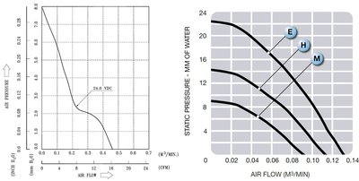

The trick is to compare the CFM vs back pressure curves. The one on the left is the 15 mm thick fan, and the one on the right is the blower (Digikey sells the "E" version):
Just as an initial data point, the fan can deliver the same 5 CFM as the free-air rating of the blower at a back pressure of 5 mm. However, at a back pressure of 5 mm, the blower can only deliver ~ 4 CFM. At least in that back pressure regime, the fan wins on CFM by 20%. At a back pressure of 6mm, the fan is at ~ 3 CFM, while the blower has barely noticed, and is still putting out close to 4 CFM. I'm not sure how I could quantify the back pressure of a shroud, but 5 to 6 mm sounds like a lot.
I've ordered one of the fans, and the appropriate connector & pins to plug it into the existing harness block. With the possible exception of the added weight it should just bolt right on in place of the old one.
