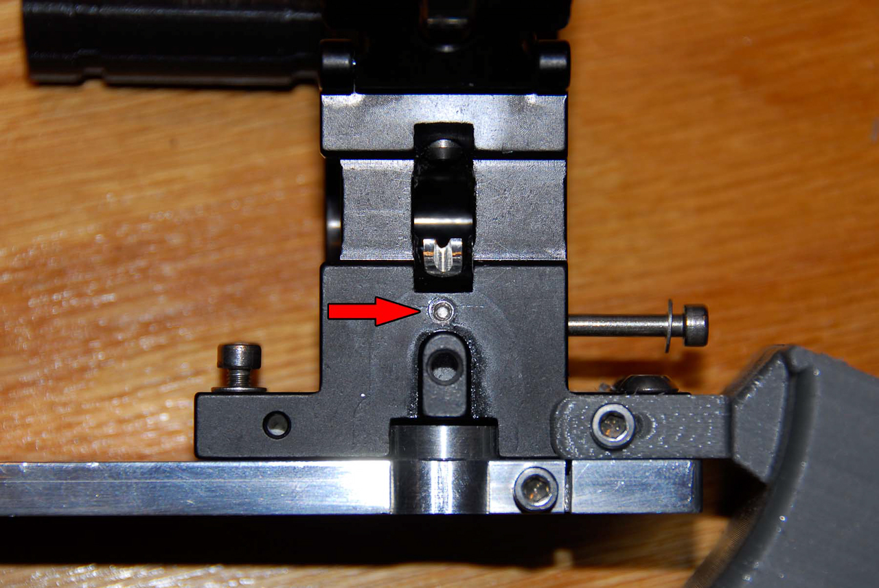

Re: Micron All Metal Extruder Upgrade
Post by sthone » Tue Oct 13, 2015 1:24 pm
Here's where I put the set screw. Give me a few days to take measurements and I'll get that insert out to you.
