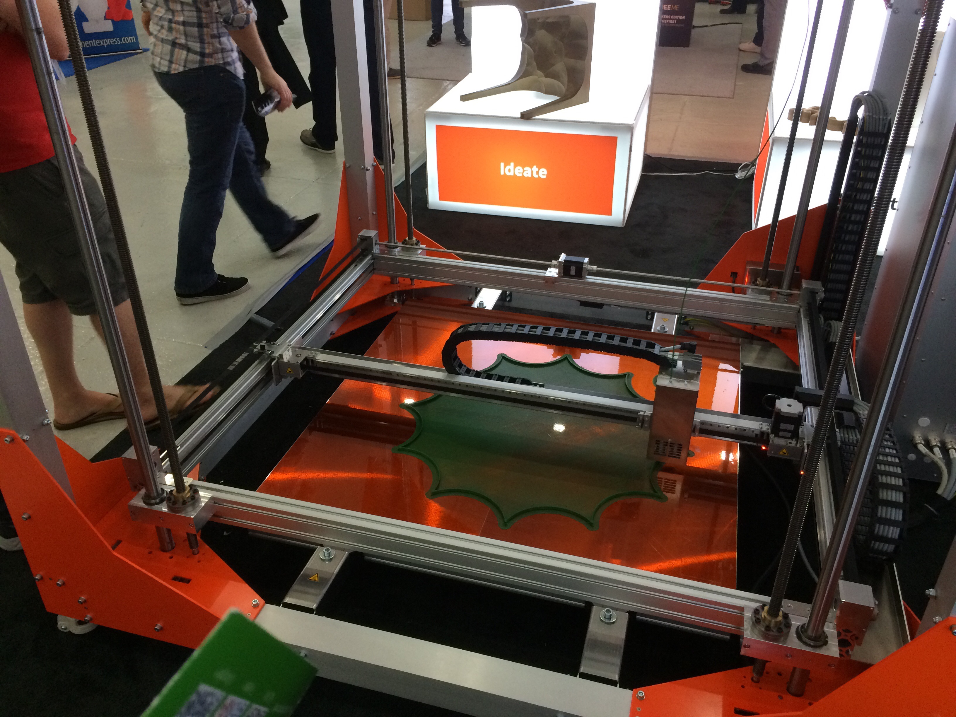

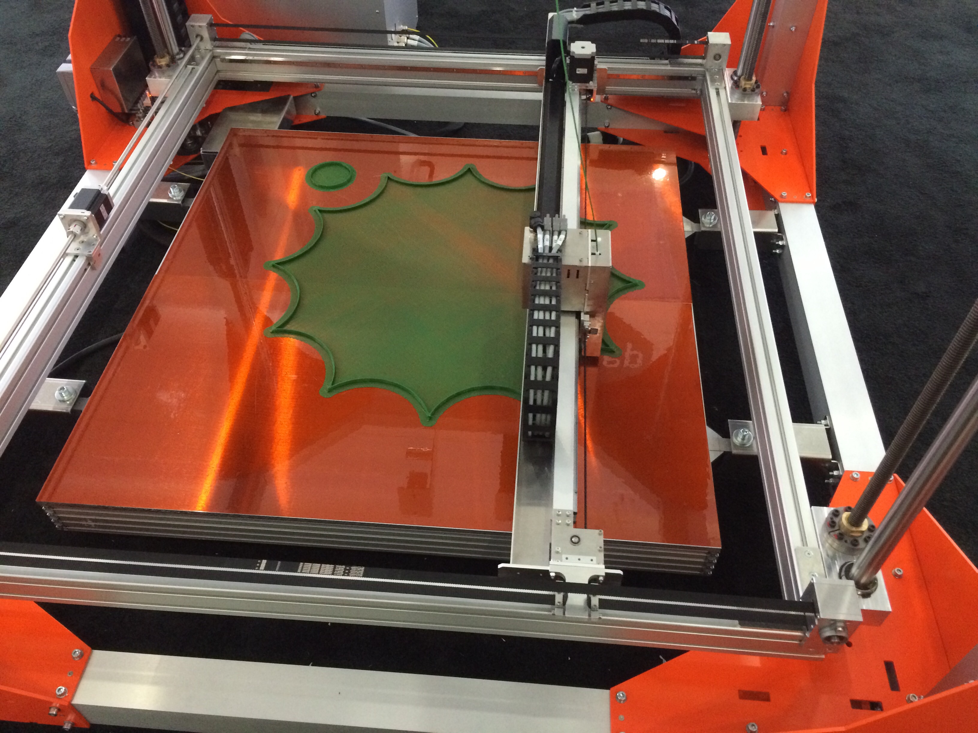

Here is one for you. Took these at the 3d print show. I know jetguy has a printer he built thats 4x4x4. I saw that one at makerfaire
(1.56 MiB) Downloaded 259 times
(1.35 MiB) Downloaded 259 times
Re: Smoothieboard
Post by jimc » Sun May 10, 2015 4:07 pm
Sorry for the img size. Posted from my phone
