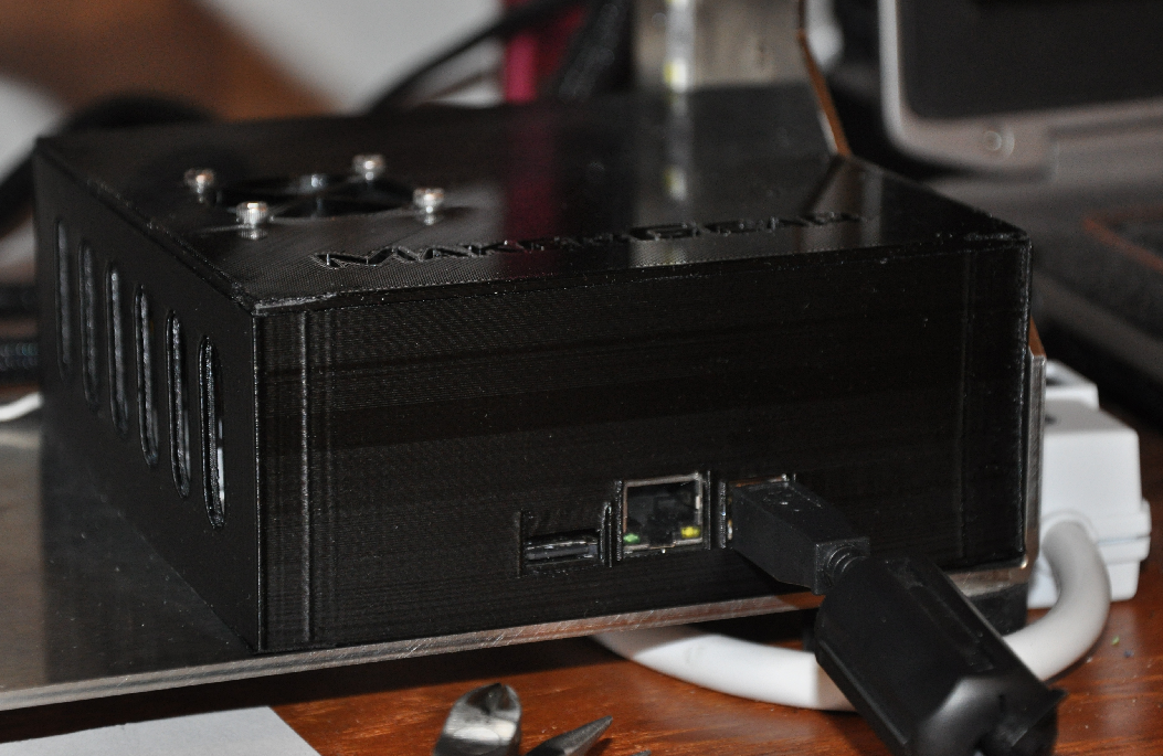

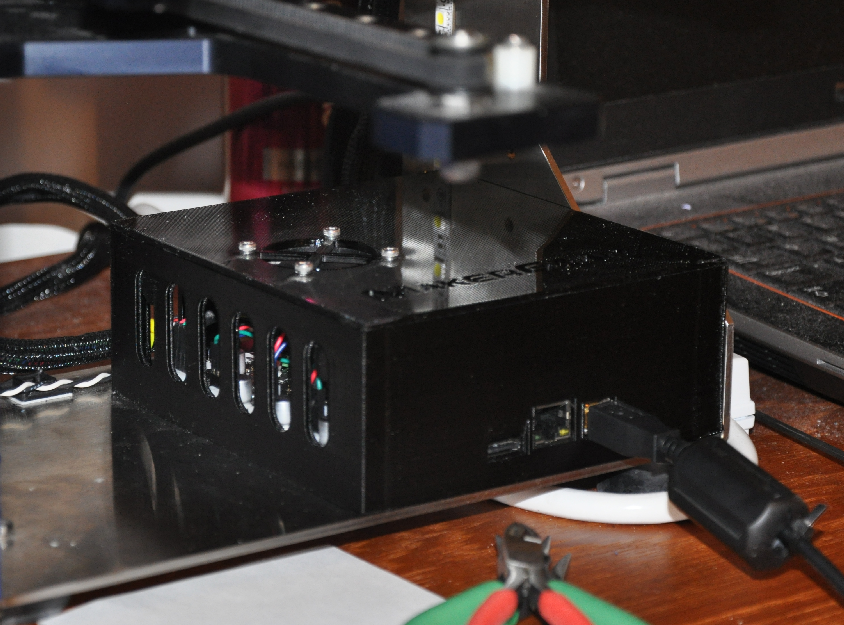

To finish up this project, I designed an electronics enclosure for the Smoothieboard. I call it the "M2 Smoothiebox" and posted it up on Thingiverse at http://www.thingiverse.com/thing:841736. The eSUN black PETg arrived while I was still designing the box, so I went ahead and printed it with the new filament. It looks great; the top of the lid, which was against the glass when printing, is a mirror-smooth gloss finish that looks like acrylic. I had a couple of jams that turned out to be due to bad settings for infill; when that was corrected, it printed without trouble, and remarkably defect-free.
Full disclosure: The one in the photo actually just barely doesn't clear the Z stage, by less than a mm. The one posted on Thingiverse is corrected. Anyway, nothing is ever Made that can't be Improved. . .
Another view of my Smoothie enclosure
Smoothieboard-in-a-box!
