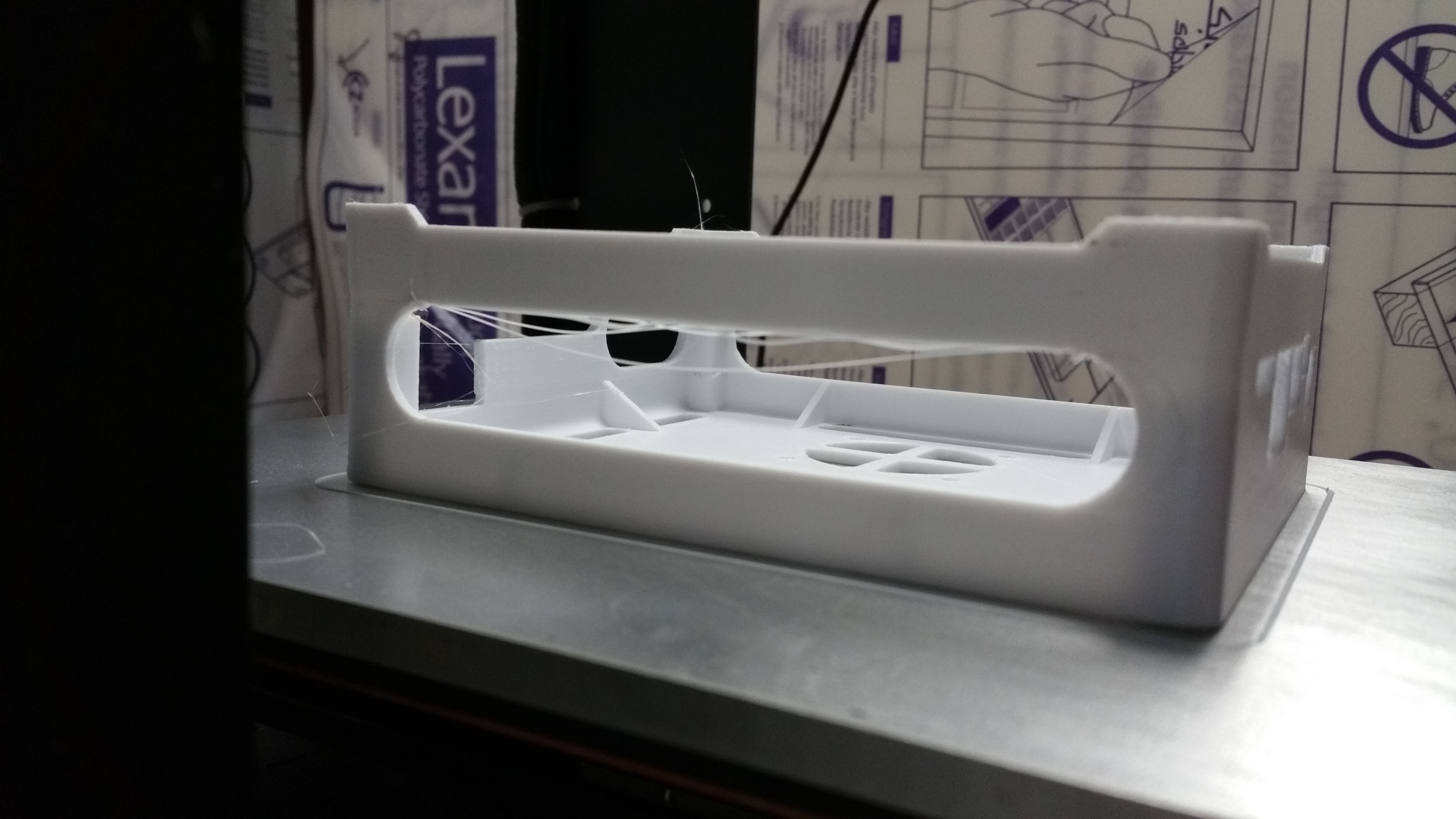

Bridging test petg.
Petg bridging. Not a perfect print ....but 5hose are some long bridges.

Holy guacamole, Batman! :shock: If that's what taking off the fan guard does, it'd be worth a few replacement fans!!!
(Still trying to figure out what needs to be adjusted while the fan is on, that causes so many folks to stick a wrench into the running fan??? :lol: )
What bridging settings are you using, PcS? That is unbelievable!

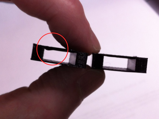

For comparison......This is what bridging PETG can look like with guards in place, full fan:
And it's actually worse with the fan off.

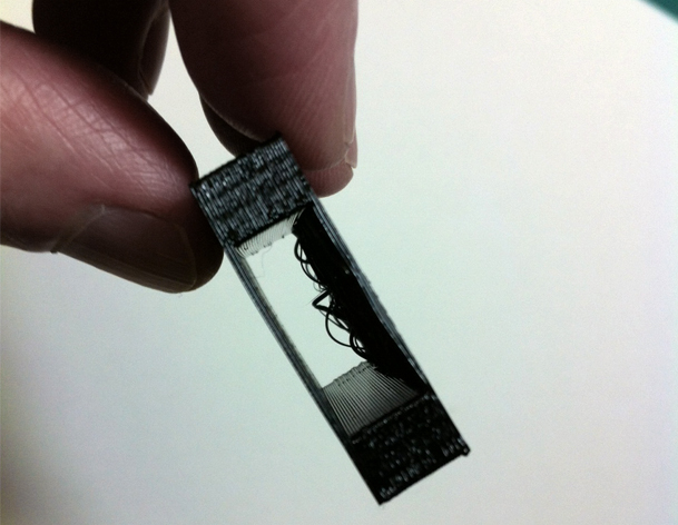

I dialed down my speeds a bit and ran a last few bridging tests. Got an okay result after the previous days of fiddling. The bridge is still sloppy, but it doesn't break or sag down too far, and at least it supports the next layer.
Then I removed the bed fan screen guard and ran it again with the same settings......
Got about a 40% improvement in the quality of the bridge, and subsequently, the quality of the top layer. The bridge strands did not sag nearly as far before they hardened.
It's just about impossible to see in a photograph, but here they are side by side, with fan guard on the left, no fan guard on the right:
Left side - with fan guard on bed fan. Right side - fan guard removed. Much neater bridging.
