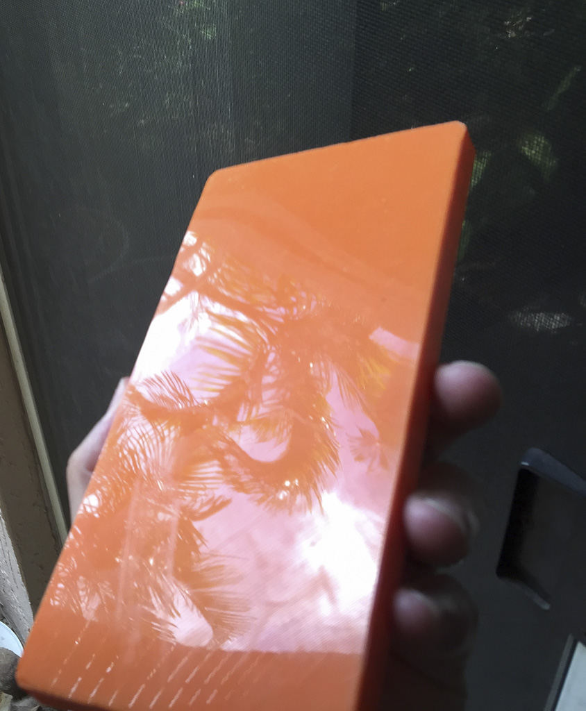

Here's what the bottom of the print looks like if you use the smooth side of the PEI surface:
You can see yourself in it! :) Those layer marks on the bottom are actually a reflection, not part of the print.
2015-08-16 12.19.04_1.jpg (239.17 KiB) Viewed 16143 times

Nice, the pattern in it almost looks like palm trees. :lol:
Re: PEI Bed Surface
Post by Jules » Tue Sep 01, 2015 2:25 pm
Yowsers! Beautiful mirror finish! :shock:

jimc wrote:Nice, the pattern in it almost looks like palm trees. :lol:
That's that new photographic filament, I'm surprised you hadn't heard of that one Jim!
