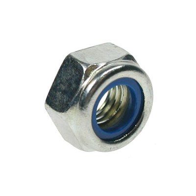

The amount of pressure on the adjustment screw is minimal. It is so light I will suggest that if you are using the new gear you may want to consider a lock nut so when under heavy vibration or filament change it doesn't move.
