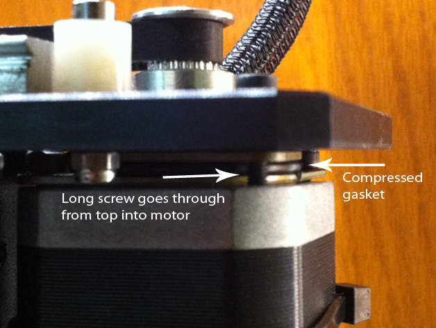

Yeah, i guess i accidentally tested it. When i put mine in, not knowing what i was doing, i didn't do it the way the rest of the guys did. I came down through the damper into the motor itself with some longer screws, compressing the rubber gasket and making the belt and the motor rock-solid and completely stable. Belt tension is actually firmer than it was before i put in the dampers.
It does cut down on the noise significantly, maybe not as much as if the motor were dangling freely from the rubber gasket, but it really cuts way down on the movement of the machine when the nozzle makes short rapid movements. It doesn't bounce around anymore, and the "ringing" with rapid direction changes has pretty much gone away. No more thunking sound either when it moves too rapidly. (I can't hear it from the kitchen anymore while i'm cooking and i have to keep coming in to check to see if it's still running.)
So after printing with it that way for the last week, i think i'm going to leave it alone. I might have gotten lucky, but i'll take good luck any day! :D
