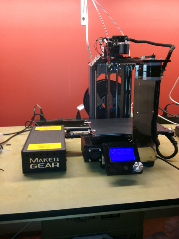

upgrade complete...finally got it all in cases...and actually using it for real work - no longer a dust collecting paperweight
though there's still dust on it have to clean off
included a pic of the end result.
24v upgrade
MKS SBASE - smoothieboard
GLCD
ZEBRA PLATE
while I was at it, I changed the electronics fan to the side, were it will not be sucking hot air in from the HBP.
I access the sd card via the usb or via the web interface, so I don't ever remove it anymore.
I can start and monitor prints via web, usb (using s3d), or through the GLCD. and can upload prints via web , usb, or sd.
mostly I just use the GLCD now to do kick off print jobs and monitor.
(ya know ... I can monitor and control from my iphone... that's kind of funny)
i'll be adding auto leveling when the parts come in, going a completely different direction then what is being done here.
all buttoned up
