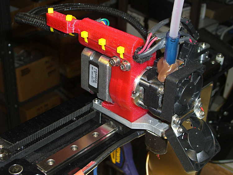

M2 Motor Mount - Cable Cap - installed
cimg7826 - M2 Motor Mount - Cable Cap - installed.jpg (88.02 KiB) Viewed 14052 times
Cheerful magenta eSun PETG, 1 perimeter, 15% 3D Honeycomb Infill, Hilbert top & bottom infill (not that it has much of either), printed with the open side of the arch downward as shown, hairspray on glass.
Turned out that 3 perimeter threads (my default) was too much for the aggressive overhangs, but 1 perimeter and no support worked fine. Negligible stringing, zero cleanup, perfect fit for those pretty cable ties.
