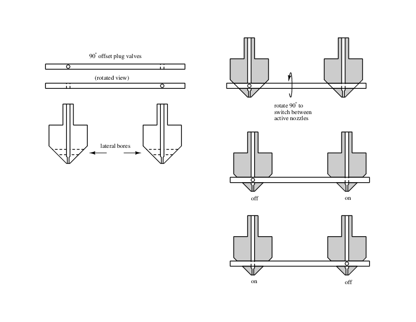

Is this feasible or is it just asking for too much precision alignment?
- Plug valve?
- plug_valve.png (15.55 KiB) Viewed 19522 times

Neat idea. But I think I'd feel more comfortable just having 2 separate motors/solenoids.Tim wrote:Is this feasible or is it just asking for too much precision alignment?
And I think this is less easy to get working than pin valves. Though, a ball valve inside nozzle is a great idea. It would require a whole new nozzle cast. I wonder if you could order a trial version from shapeways. Does the laser printed brass stand up to heat well?
