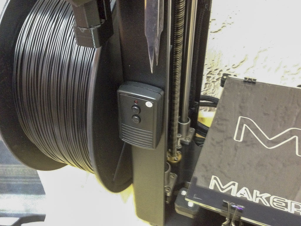

Mounted the wireless transmitter with double-sided tape:
2014-09-26 15.49.08_1.jpg (179.28 KiB) Viewed 15584 times

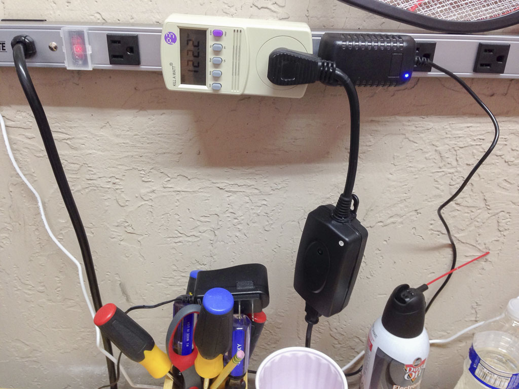

The black box is the receiver, and its shown connected to the Kill-A-Watt:
2014-09-26 15.49.18_1.jpg (187.39 KiB) Viewed 15584 times
The Kill-A-Watt reads about 3.8 Amps max. I assume that's an average since its a switching power supply, not sure how that translates over to the AC side. Reads .2 amps with the printer idling.
The receiver unit has a relay not a solid state switching device rated at 13 amps so it seems to be handling things well.
Keep in mind that this is a 24volt M2 which may pull lower current than a 12 volt version, again not sure how that translates to the AC side since I usually work on the DC side of things.
