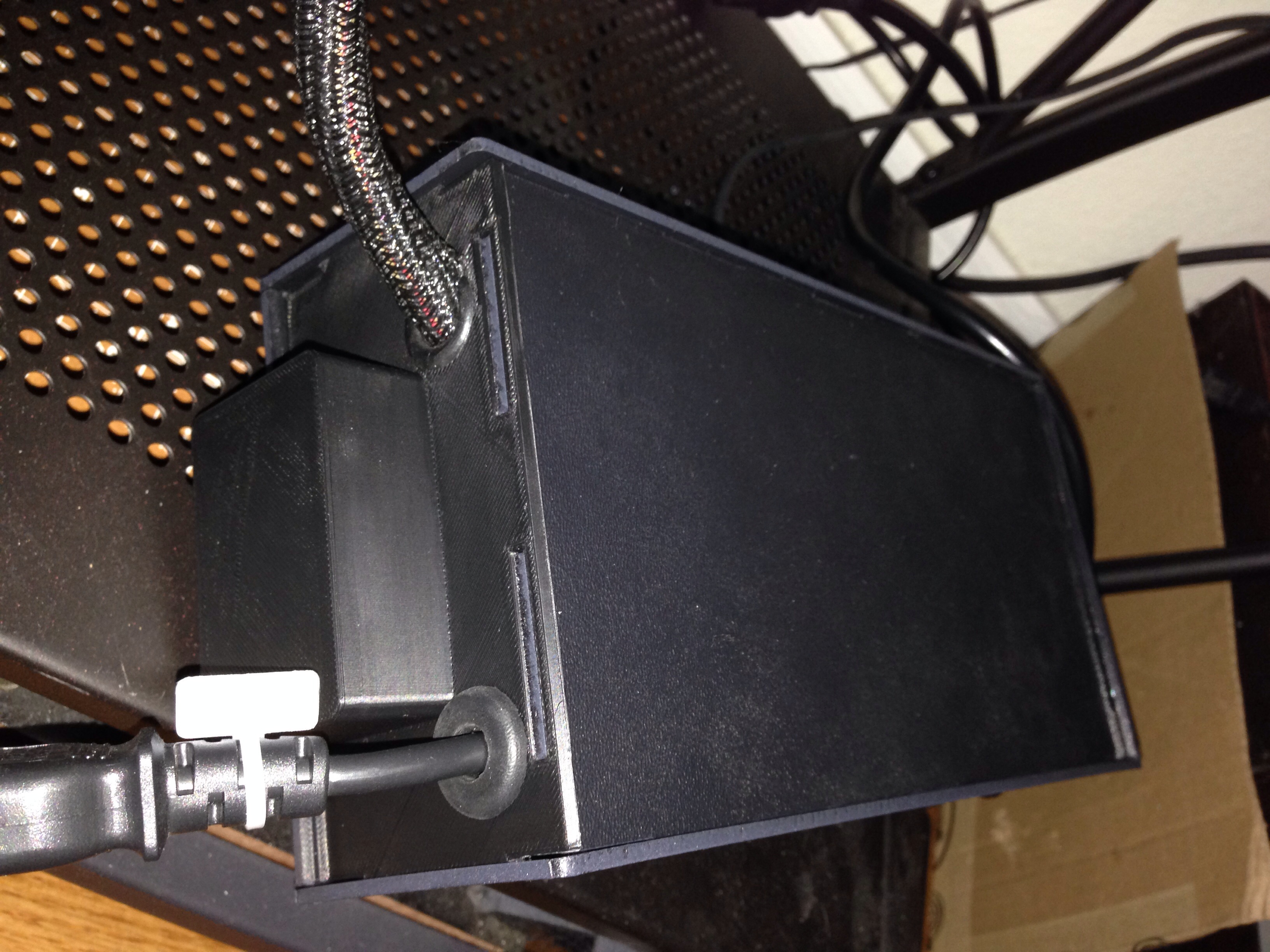

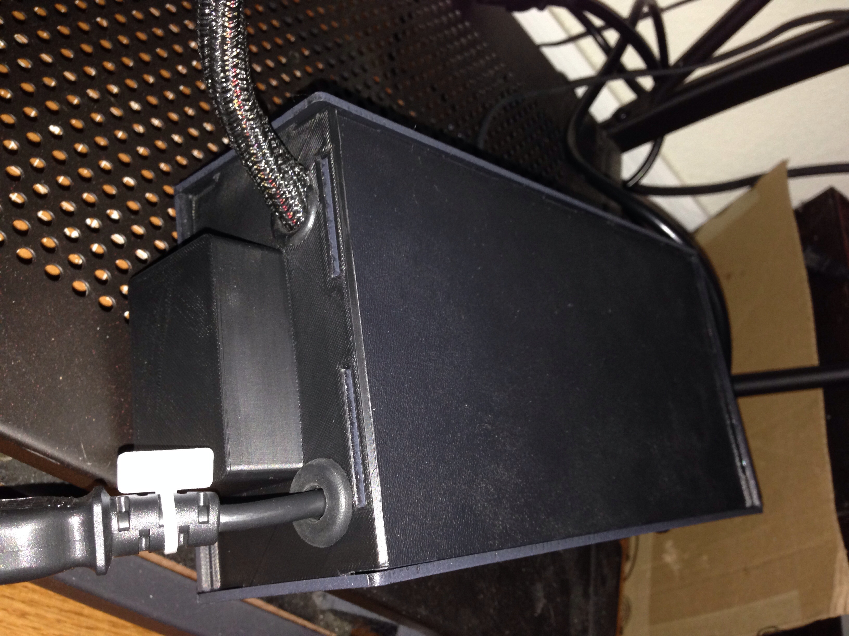

I like the others love Octoprint! I have it setup to control a relay so the printer will shut off after a print. I will be posting pics in a few days of my modifications I've done lately with the relay. Here is a pic of my modified power supply that now houses the relay.
- Modified power supply
- (1.65 MiB) Downloaded 1145 times
