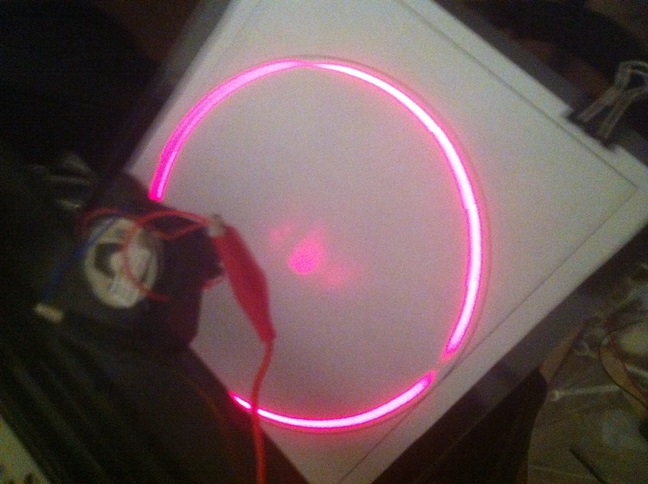

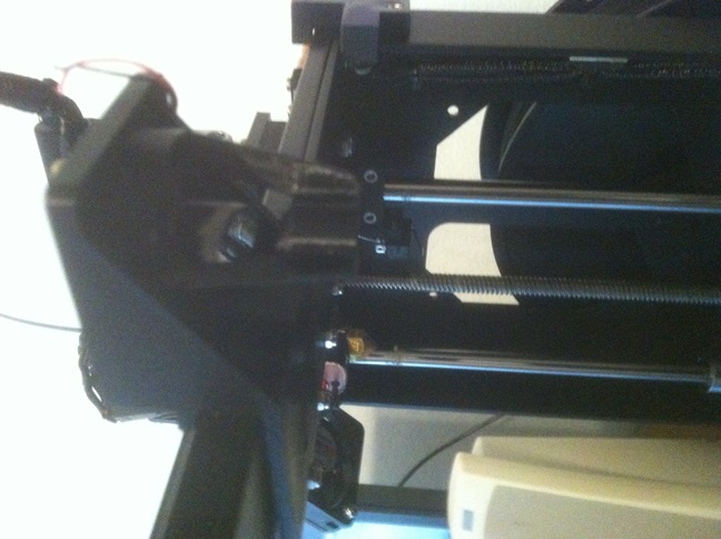

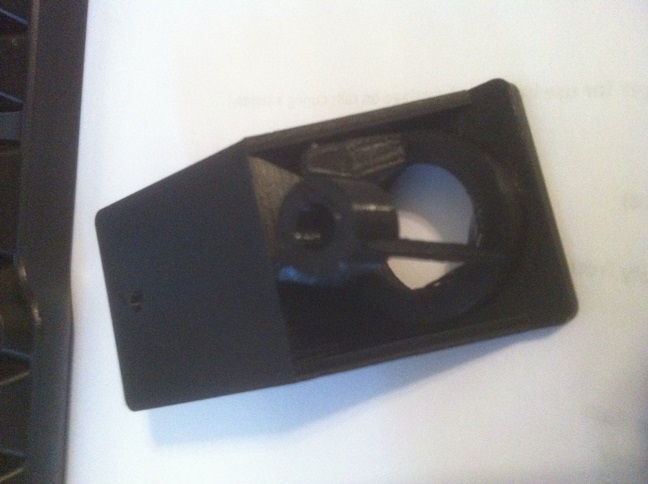

I agree that dial indicator might be more accurate. I do some CNC work so I am familiar with their use. I think the advantage i was looking for was the ability to speed up the leveling process by getting feedback on what adjustments were doing without moving the table around. I designed a prototype and built one in a few hours with < $10 worth of parts. The unit can be permanately mounted on the M2 without interfering with anything else. As far as magnifying the error, the laser is projecting an 8" circle from 1" above the platform, so errors will be magnified. The laser module I used for the prototype was a very inexpensive one ($3) and would require a lens to make the circle very thin.

How do you set absolute level with the laser?

Well, it's good that you are actually trying this since that is the only way to ever know for sure. The rest of us are just theorizing.
Since the bed is leveled in relation to the X-Y plane that the extruder nozzle operates in, how are you aligning your laser circle to that same plane? I guess you'd have to first level the table using the traditional methods and then adjust your laser to align with the calibration circle on the bed. Of course now THAT will also have to be periodically checked to make sure it is also level with the extruder plane, otherwise your level checker could itself get out of level. If this method is accurate enough, the advantage would be not having to move the extruder head around. You should be able to get the table level faster with instant feedback from the circle distortion.

Capt. John,
The way you set the bed level would be to insure that the circle being projected on bed is perfectly round by comparing it to a reference circle printed on the bed. The circle will only be perfectly round is the bed is exactly perpendicular to the laser. If the bed is not perpendicular (not level) the circle will be an ellipse. Think about an object being illuminated by sunlight. The only time the object will not cast a shadow is if the sun is directly overhead. If not a shadow exists and the farther away from perpendicular the object is the longer the shadow.
Hope that explaination helps.
Pyrnaught,
I printed a model with bores for the motor and laser perpendicular to the mounting surfaces. I then mounted the bracket to the same surface the extruder head is mounted off of. If that is not accurate enough to get a good level platform, I would probably need some adjustments on the mounting as you suggest. It would be interesting to place jimc's leveling print on the platform and see how much distortion I get in the circle for the different height lines.
Pyrnaught,
