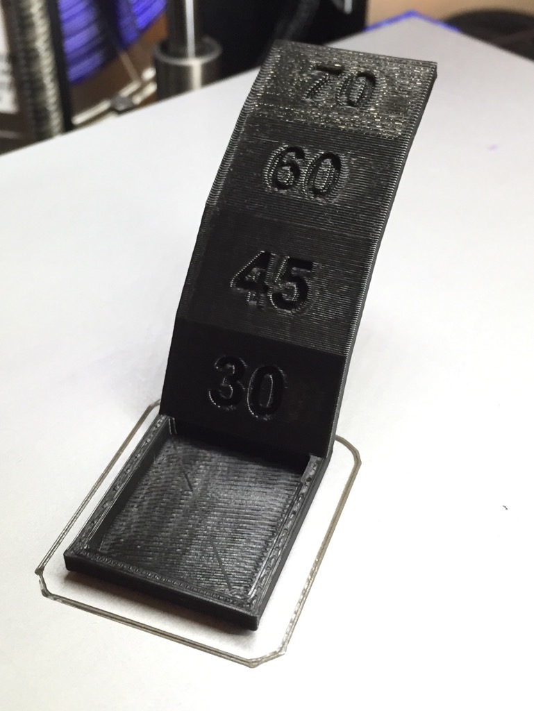

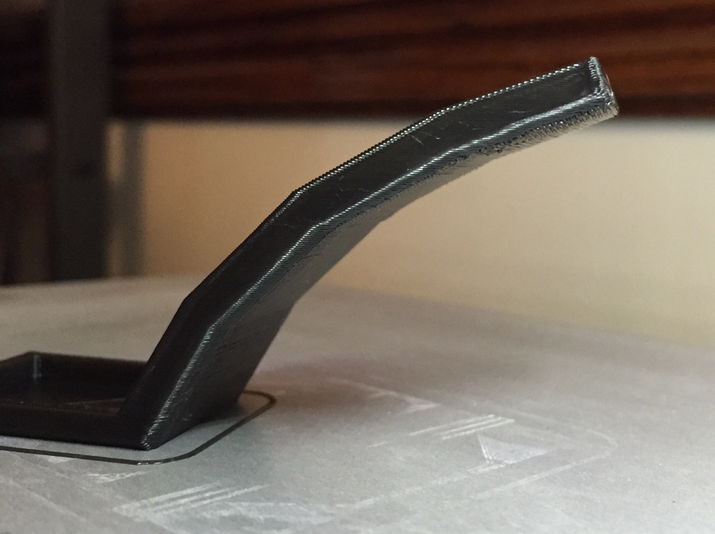

Tried it with the Make magazine overhang test. I printed with the overhangs facing the rear of the bed. It is also tilted 30 degrees to the left to offset the unused nozzle off the line of horizontal edges so that it doesn't interfere. (For this print it ended up not making a difference, but I've found that if there is any curling, the unused nozzle can pass over it and tilting the print slightly can help alleviate that.)
Up to 60 degrees, the leading edge was dead flat. At 70 degrees I started to see some edge curling and the bottom surface reflects that, but it still printed successfully. If I wanted to get the best possible print, I would slow it down and print with the leading edge pointing forward, towards the fan, but I wanted to see what the worst case scenario looked like. I should have done a similar print before I messed with the fans, but I didn't and I'm not inclined to redo it. Based on the amount of curling I was seeing before, I would say that some combination of my new fan and the shroud has made a noticeable difference.

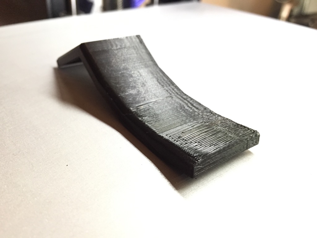

Just to use up the dregs of a roll, here's a print at 40 mm/s facing the fan. A very slight imperfection along the right side; I'm printing out the right extruder and the right side gets a little bit less cooling than the left.
