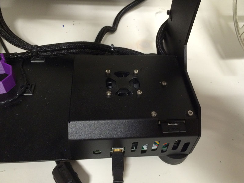

Post by jimc » Sat Mar 21, 2015 10:32 pm
the new m2 i just got here has the metal enclosure. i had to email rick when i got it saying how nice that was. way nicer than the stock plastic box.

Post by jimc » Sun Mar 22, 2015 4:14 am

jimc that is definitely a nice setup and a big step forward as far as looks are concerned...
