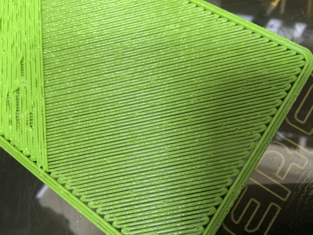

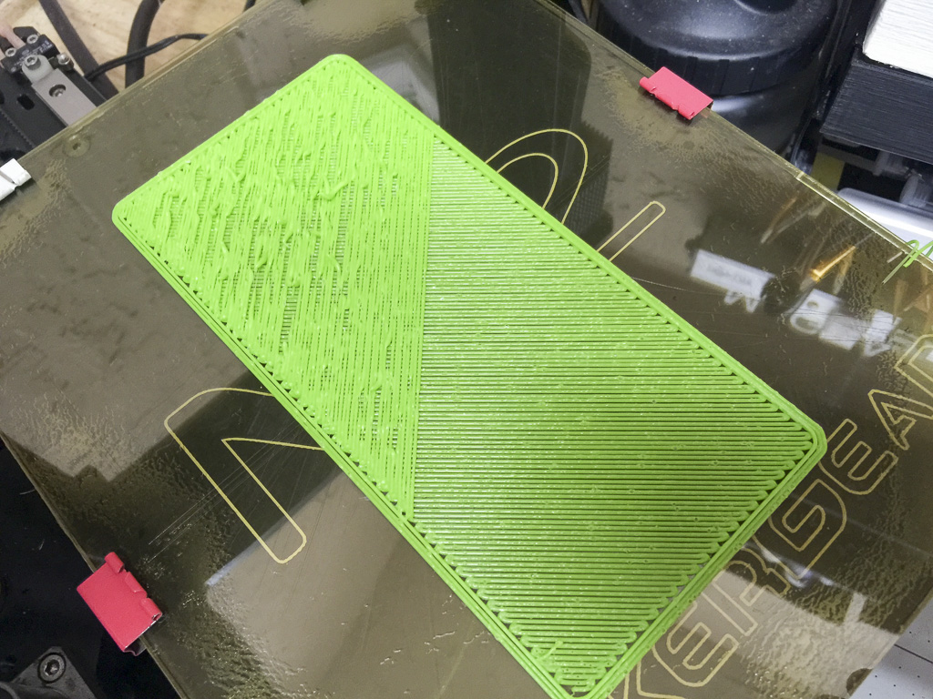

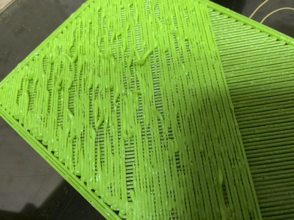

I installed a volcano last night to try and speed up some of my production prints. I printed a 20mm x 20mm x 2.4mm cube following jsc's tutorial ( viewtopic.php?f=3&t=1964 ). I have the height at 2.4mm since I'm using a .6mm layer height with a .8mm nozzle. Width is set to 1mm. Everything came out pretty close after a few adjustments to the cube settings. So I then proceeded to try the first print. This particular print I usually do in pairs and they take about 9 - 10 hours to print. So I'm trying to cut the print time down to half to increase the amount I can make in a 24 hour period.
EDIT: Speed is set at 60mm/sec
Hotend is set to 240 Bed at 103
Anyway, here's what I got after the calibration with the cube when printing the first print. (Note: I didn't do any calibration to the infill settings yet). I remember having that issue when I first got the printer with my .35mm nozzle, but don't recall what was causing it.
Here's some pictures and a factory file if anyone gets a chance to comment. I'm sure you'll find lots of wrong settings as the larger nozzle size appears to require totally different settings.

It looks like the first layer went down fine, then the second layer wants to stop and drool every so often. The only difference would be the first layer width and print speed, so try extruding a fair bit in open air at your second layer speed and see what happens. Can it keep up with that much flow?
Your width-over-thickness (WOT) ratio is a little low, try .5mm and see if that helps.

jsc wrote:It looks like the first layer went down fine, then the second layer wants to stop and drool every so often. The only difference would be the first layer width and print speed, so try extruding a fair bit in open air at your second layer speed and see what happens. Can it keep up with that much flow?

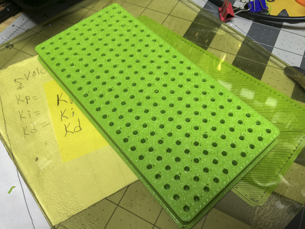

Getting there! Still needs tweaking. My real concern was the holes and they are actually coming out great. Went from 4-1/2 hours with the .35mm nozzle at .3mm height to 1hr 50min with the .8mm nozzle at .6 layer height. That now means that instead of 5 per 24 hour period I can do 12! It's almost like having a second printer. This one was done at 8% infill, I'm going to add another solid layer to try to smooth out some of the kinks.
Well back to tweaking...

I slowed it down from 60mm to 40mm and raised the temperature by 5 degrees. But I brought the temperature back down now, I don't think that had anything to do with it. Doing another set now after some other tweaks.
