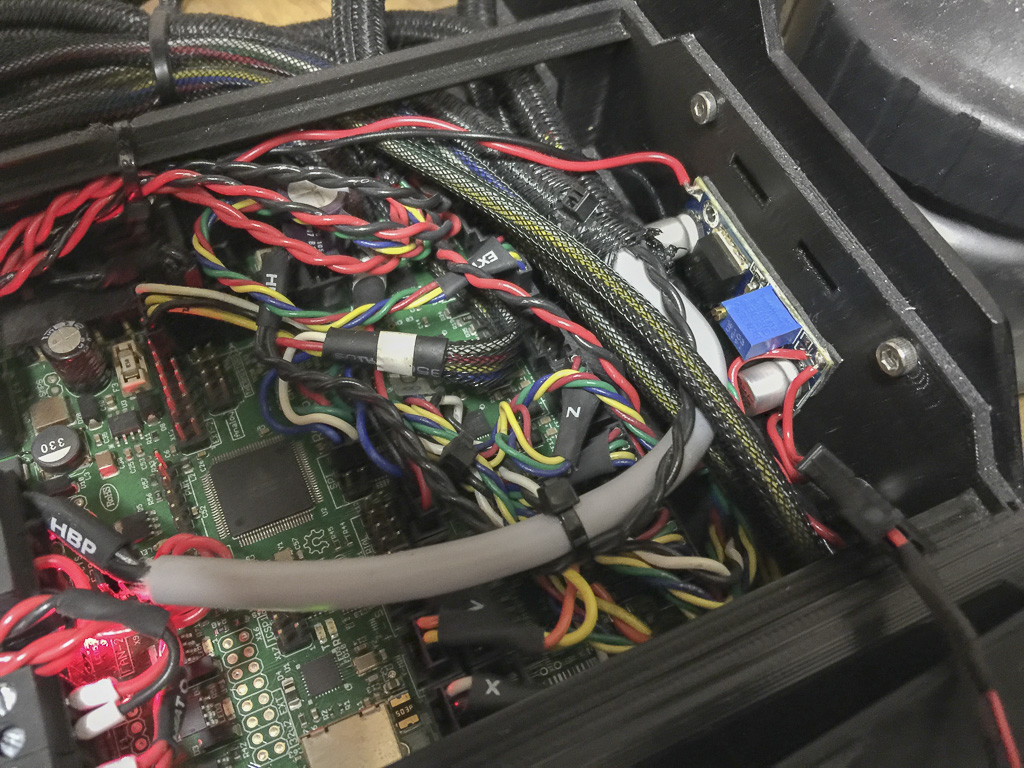

This is the completed installation. The Buck converter I mounted on the right side wall of the case with 3M double sided tape. The blue piece on it is the adjustment for voltage.
2015-09-14 17.47.30_1.jpg (384.36 KiB) Viewed 10196 times

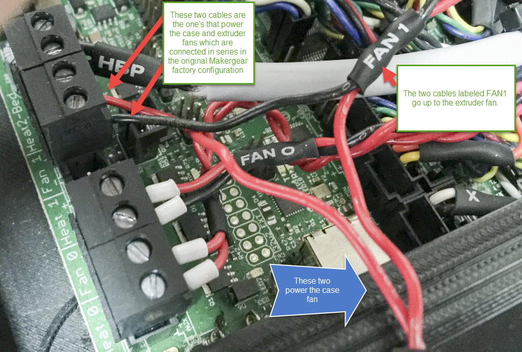

This is the original factory wiring. I removed the two power cables shown and ran new ones from those same connection points to the input of the Buck DC to DC Converter. Once that is done adjust the output voltage on the converter (I adjusted mine to 13.5v). Then connect both negative wires from the two fans to the negative OUTPUT of the converter and both positive cables to the positive (+) output of the converter. And that's all there is to it.
2015-09-14 17.01.53_1_A.jpg (240.88 KiB) Viewed 10196 times

Looks good!
I'll add what I said to you in an email, which is that the same converter is great to use for LED strips, which are usually rated 12V.
I don't suppose that the fans draw enough power for thermal considerations to be relevant, but make sure it isn't getting warm enough to make the double-sided sticky tape gooey.
Good point, thanks for mentioning it. I just went and checked (its been running about an hour) and its cool to the touch. Should be ok, but for those of you doing it there are mounting holes on the board, I do recommend you use them. It's one of those "do as I say, not as I do" situations. :)
