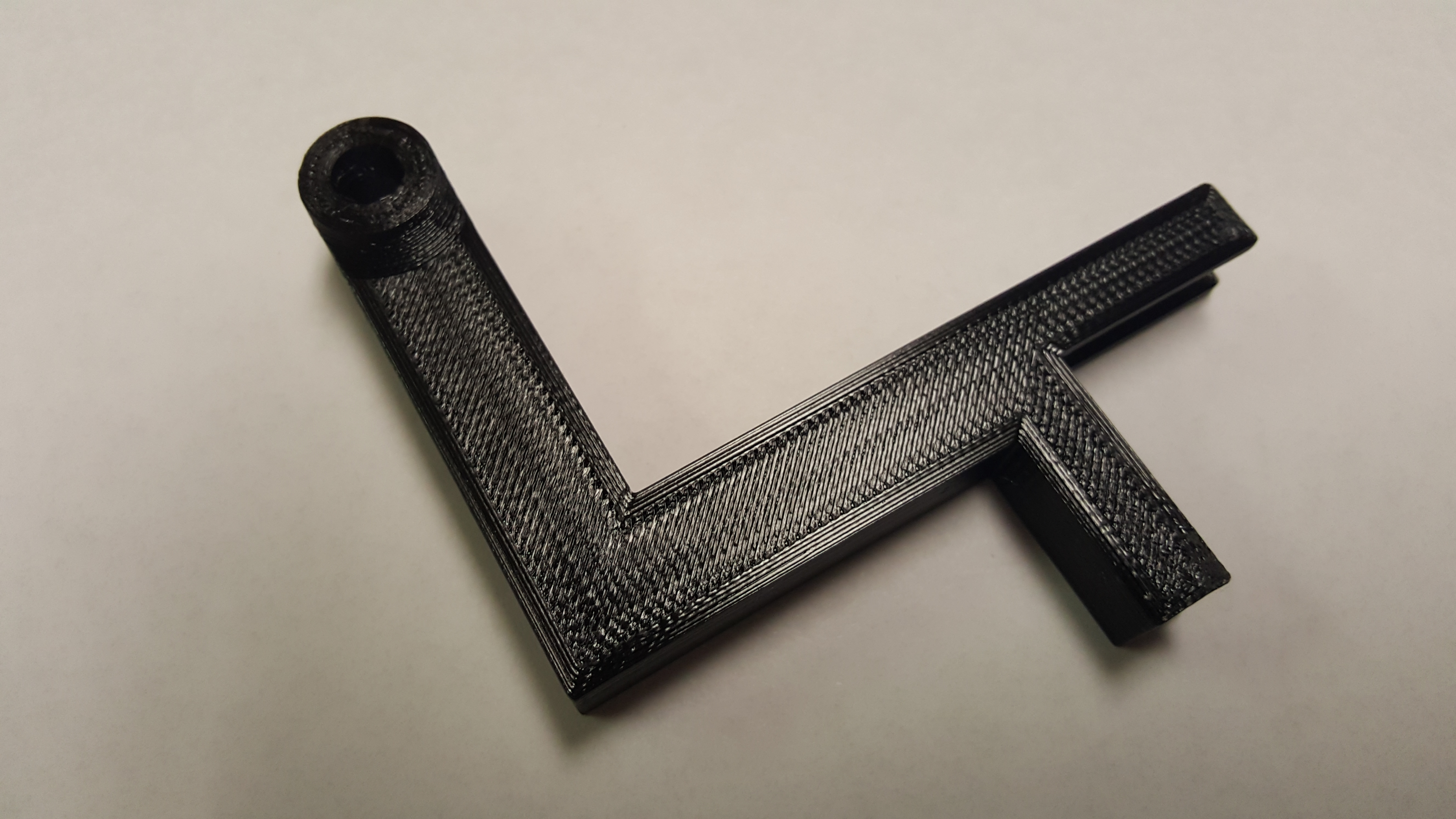

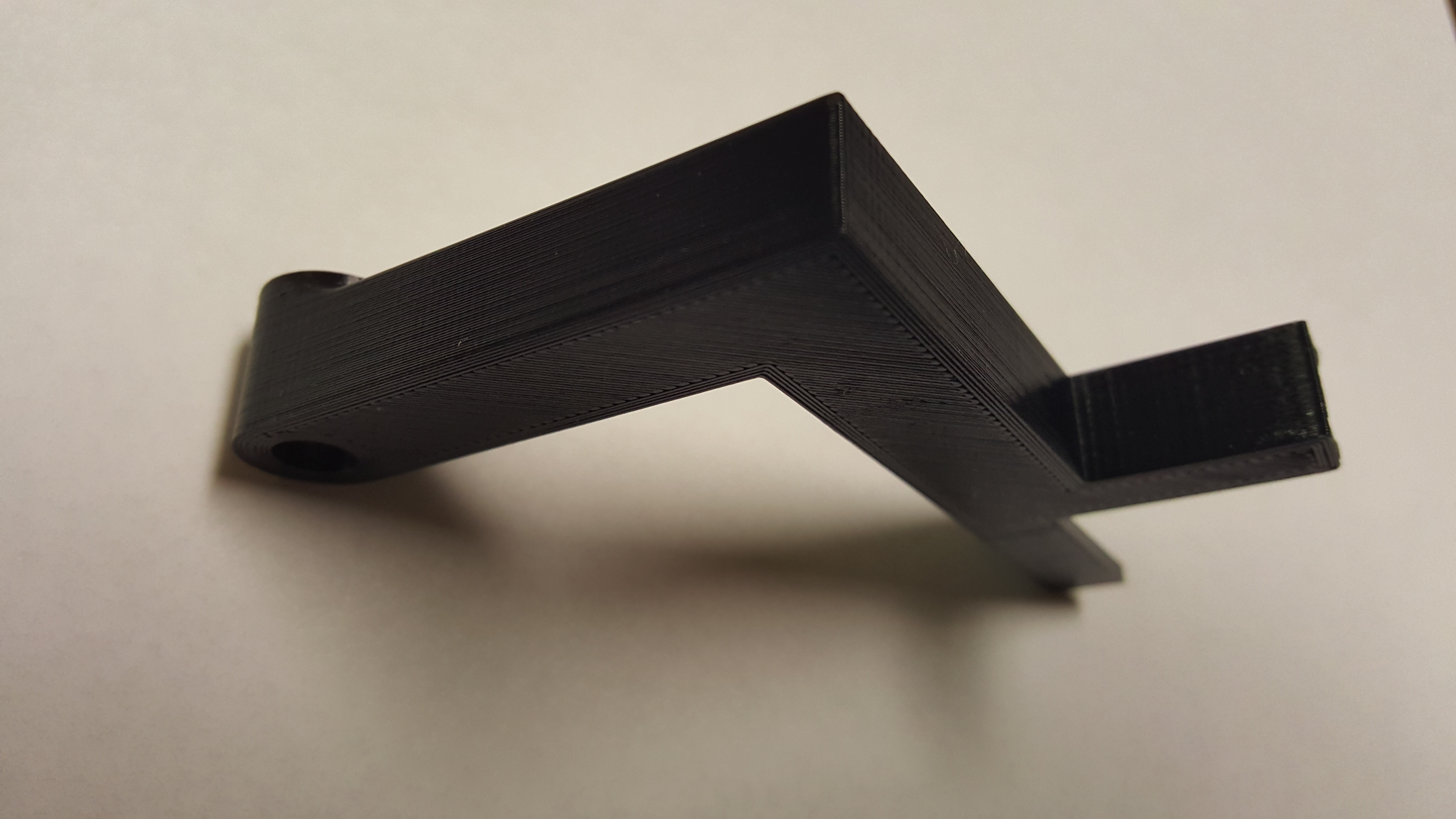

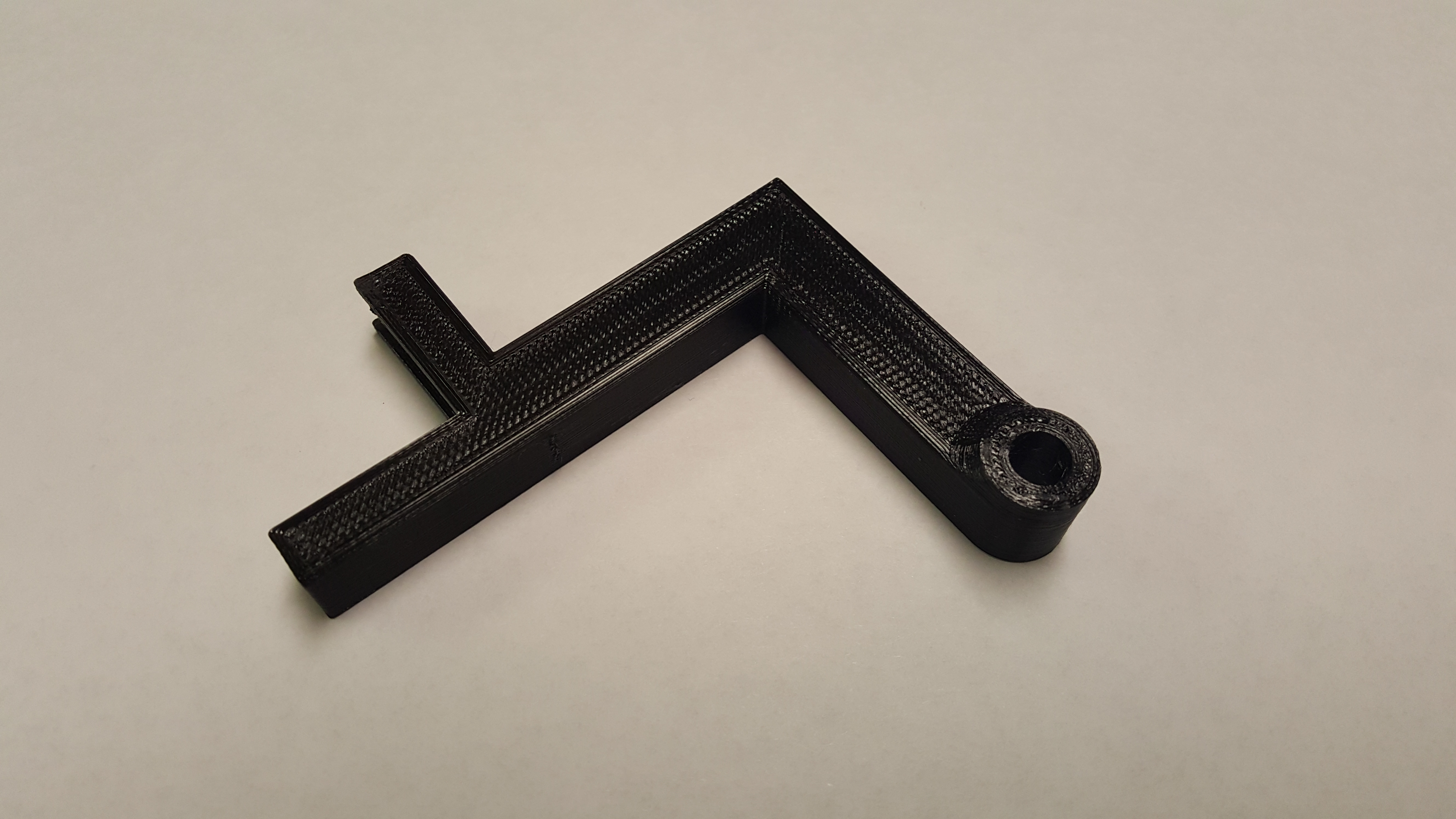

Link to video of one of the first good prints. Been a struggle getting things dialed in ...but getting close. Need more time with it to come to any real conclusions about it.
Re: Fastbot bbp1s
A simple print but good results. I will say I am impressed.
