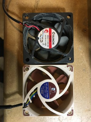

1x60 Sunon KD1206PTB1
- Air Flow 23.5 CFM
- Static Pressure 0.210 in H2O
- Noise 34.5 dB(A)
Noctua A6x25 FLX
- Airflow 17.2 CFM
- Static Pressure 0.218 in H₂O
- Acoustical Noise 19,3 dB(A)
(Chao Jing Yin) CJY Brushless DC fan
only data i could find is on amazon
http://www.amazon.com/40mm-Amounts-Moun ... B00I50GAZG
- Airflow 8.0 CFM
- 34db Noise Level
(i really can't find any official page for this CJY)
Noctua A4x10 FLX
- Airflow 4.83 CFM
- Static Pressure 0.178 in H₂O
- Acoustical Noise 17,9 dB(A)

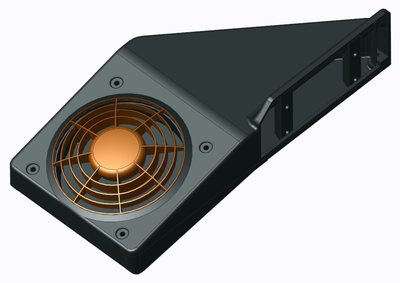

Jules - I actually printed my own guards that seem to be about the same Db as running without them (see below). Let me know if you'd like the files.
Pekish - thanks so much for the info and pics mate, very much appreciated! I'm running a mount / shroud I found on thingiverse a while back that seems to work well for me. I'll replace the 3 then and just deal with the bed fan noise when printing PLA.

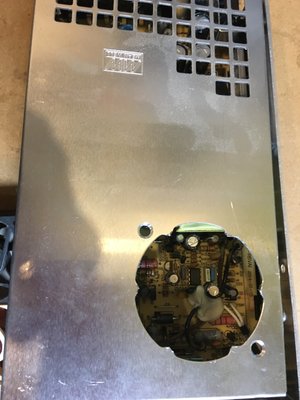

I recently changed out the extruder and electronics fan for the 40mm Noctua. I bought the Noctua 60 as well but thought cracking the internal case on the power supply more than I wanted to tear into.
