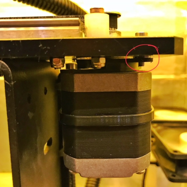

I have them installed on X and Y. I have thin washers as shims on the outboard screws (one on the motor, one on the damper) which causes the motor shaft to lean out a touch when loose. I then tension the belt until it runs centered in the motor sprocket indicating the shaft is perpendicular to the belt line.
I've done test prints with and without to see if the reduced rigidity of the axis drives impacts ringing on the parts and could see no difference at all in the prints with and without the dampers.

Figure the dampers are a rubber spacer between the motor and the machine. If the motor is square to the frame when mounted, applying tension to the belt will cause the motor to lean into the belt and the shaft is no longer normal to the machine frame.
I installed thin washers on the outboard screws - one of the outboard screw locations with the washer is circled in the photo above. The washer causes the motor shaft to point slightly outward from the belt line. The reaction to the belt tension causes the motor to lean into the belt which moves the motor shaft into a normal orientation to the machine frame and belt line.
