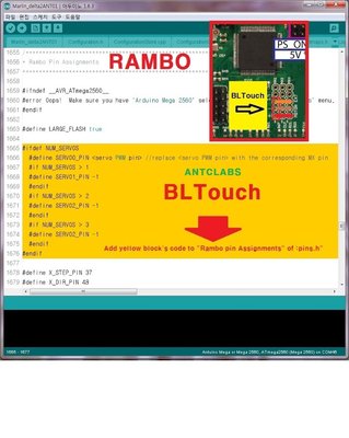

Here's the only info I found on the BL Touch google group doing a search for Rambo.
https://plus.google.com/communities/109 ... 14/s/rambo
I assume the second connector goes to one of the limit switch ports?

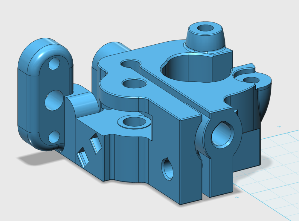

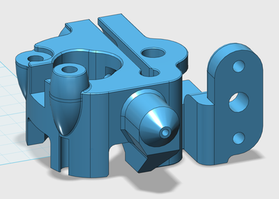

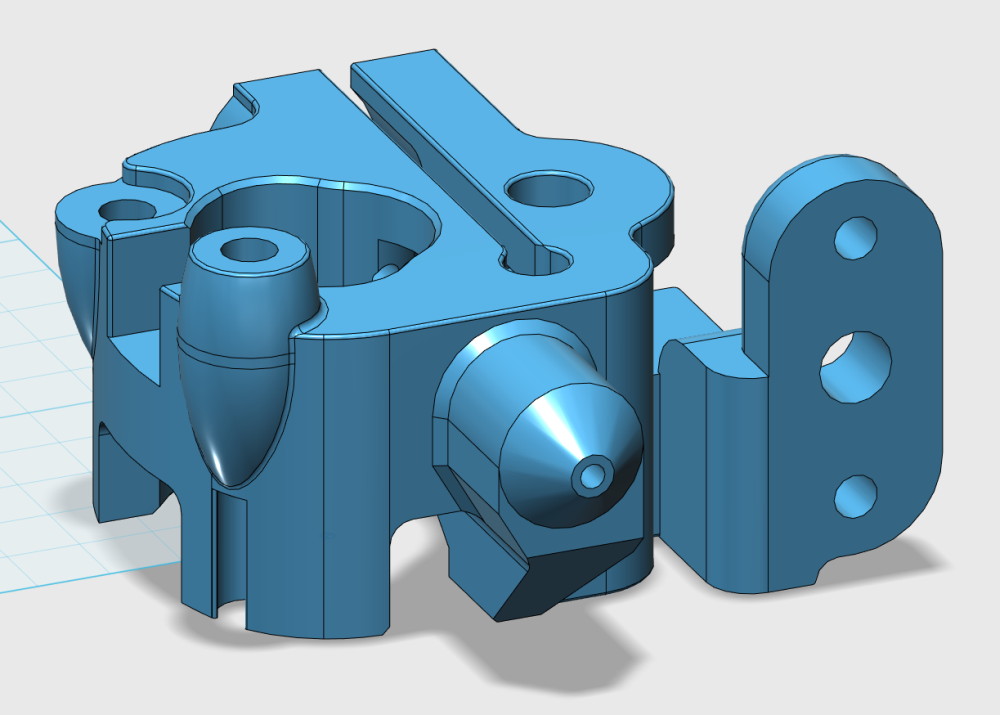

Post by tks546 » Fri May 27, 2016 3:07 am
Here's my first attempt at a mount. I haven't printed it yet just roughing it in.
-Tom

Step 10: Navigate to the Pins.h sketch.
Search for the "Rambo Pin Assignments" section.
Add the following line just before the "#endif //RAMBO" line:
#define SERVO0_PIN 22
This line assigns the signal from pin 22 to Servo zero (servo numbers start with zero).
Save the sketch. Upload your firmware using the Arduino IDE. (Check YouTube if you don't know how to do this.)
