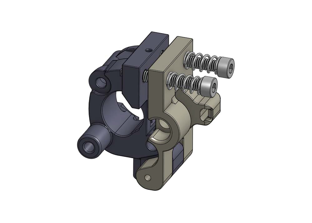

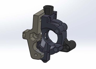

This is work in progress but I thought I'd share along the way.....

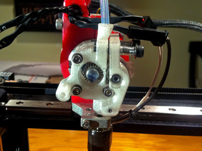

I started to have problem on one of my printers lately where it would just stop feeding. I tried adjusting the feed tension but even tightening it as tight as it could go I couldn't get a good bit on the filament. Taking the filament drive apart it looked like the springiness to it just wore out, plus the offset bolt in relation to the bearing always kind of bugged me as I figured it just wasn't getting even pressure on the bearing so I figured for shits and giggles I'd try to fix it.

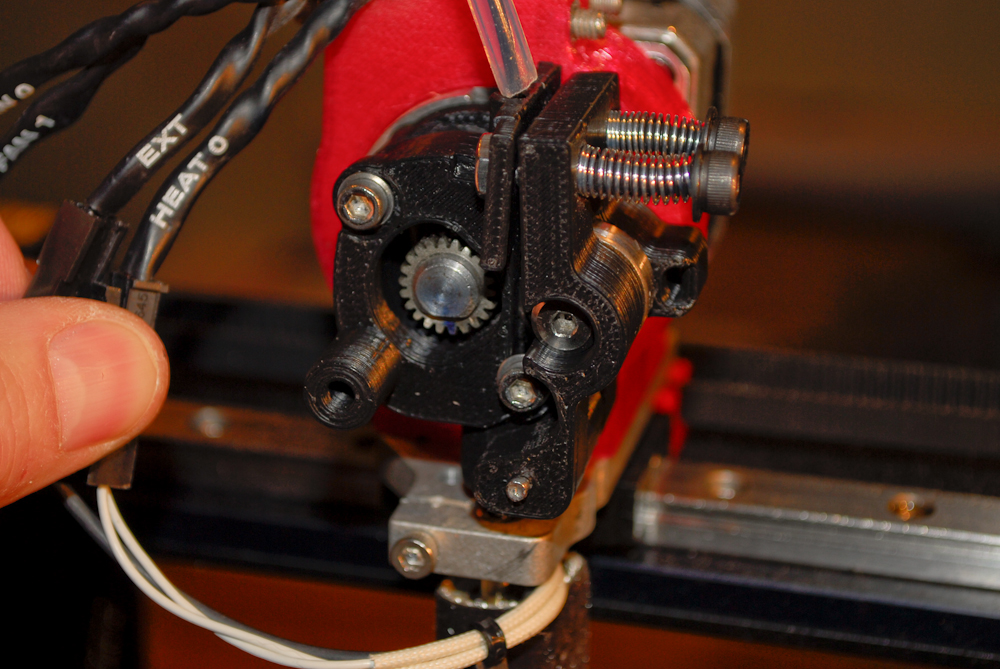

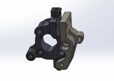

I modified the original drive to add another bolt on the other side for even pressure and incorporated more of a hinge with a pin at the bottom to see if this would keep it from wearing out.

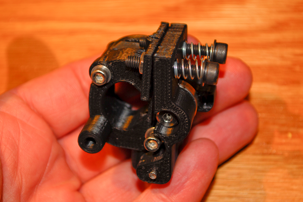

I've always been intrigued with the spring loading bearing on my Micron Extruder so I thought I'd give them I try on this one too.

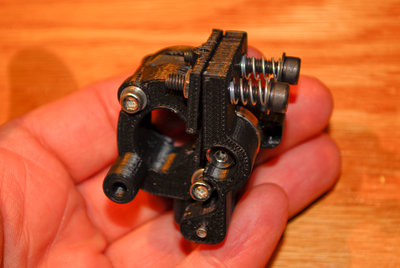

Here is the initial prototype... I've changed a few things in the design since I printed this but it should work for a test.

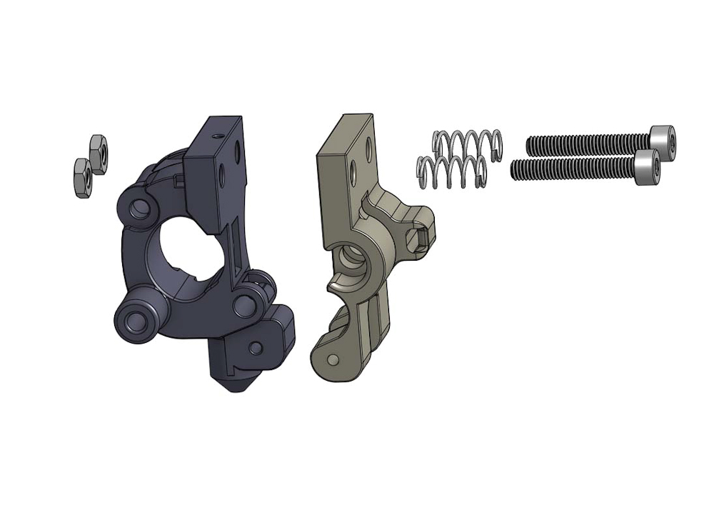

So far I've just been experimenting with a few different springs to see what happens and so far it seems to work ok. For the first printing test I did remove the springs though and just used two of the standard stock bolts. I'm printing the revised version right now so I'll have to see what happens and go from there.
Re: Modified (Hinged) V4 Single Filament Drive
Post by Jules » Thu Jan 21, 2016 3:28 am

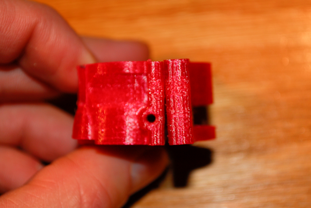

What's that original drive printed out of Steve? PETG?
Posts: 890
Post by sthone » Thu Jan 21, 2016 4:18 am
Yes PETG.. they been on there for almost nine months though.
Post by Jules » Thu Jan 21, 2016 4:28 am
I've noticed that my little PETG spring under the bed has deformed a bit after several months of use too. (The PLA one went kaput rather quickly though, so it's still a better option.)
Bummer! :roll:
