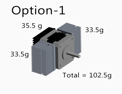

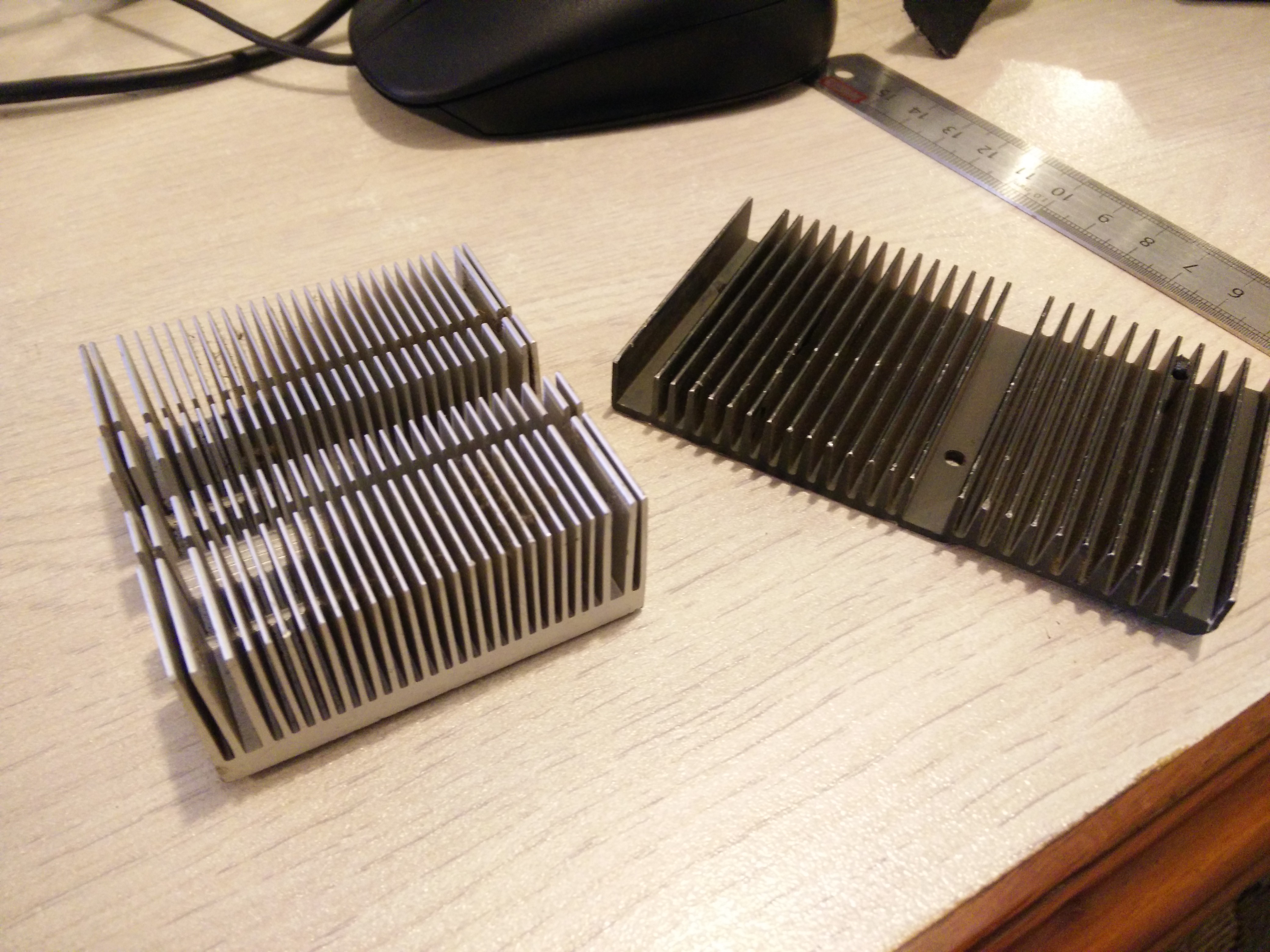

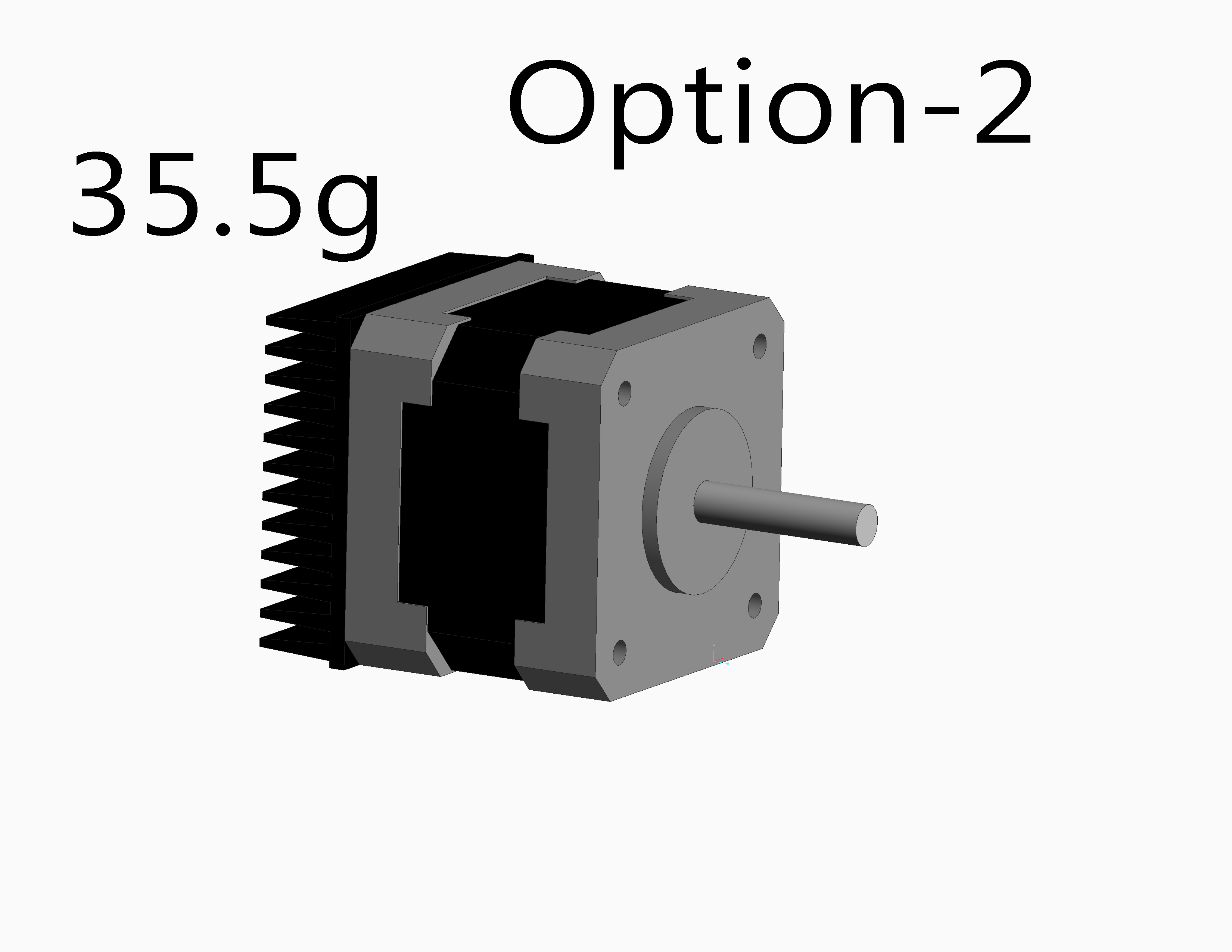

Hey all, I'm fairly new to the M2, and I've noticed that the extruder motor tends to get very hot during long prints. Sometimes I can't touch it for more than a couple of seconds. I'm not sure if it's okay for them to get this hot, so I'm attaching a heatsink to the motor. I found a couple of heatsinks at the electronics scraps store and I'm cutting them to size. I've attached pictures of the options I'm considering.
My questions though are these:
1) Do I NEED a heatsink on the motor? Or is it normal for the extruder motor to get hot?
2) If I do attach the heatsinks, will their weight on the moving carriage affect the performance of the printer? Option-1 adds approximately 102 grams to the carriage, and option-2 adds 35.5 grams.
3) Is there another simpler solution out there?
All thoughts appreciated
Marvi

I have never heard of the need to put a heatsink on any M2 stepper. You may only be fixing a symptom of a larger problem causing your overheating. Most of the time, it is too much current, a wiring issue, or perhaps a mechanical issue in your gearbox.

normal operating temp for an m2 extruder stepper is in the mid to upper 60c range. well within kysan's operating temps. while a heatsink wont hurt anything, its definitely not needed. many people here even run their m2 in semi heated enclosures with no issues.

Thanks willnewton and jimc, if people aren't having issues its probably me over-reacting, or a singular problem with my machine. I'll try attaching a thermometer and monitor the motor for a bit for a better idea of the situation.
