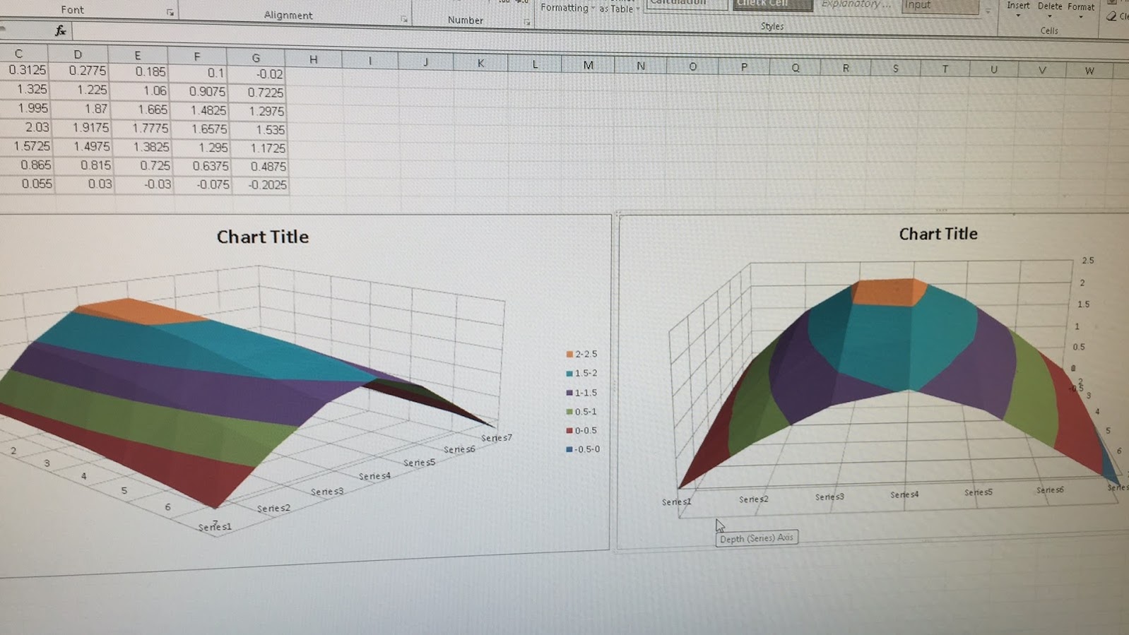

Here's the mesh data from the bed. You can see the hump in the middle caused by the SD card, the orange spot is where the bed was unlevel left-right.
