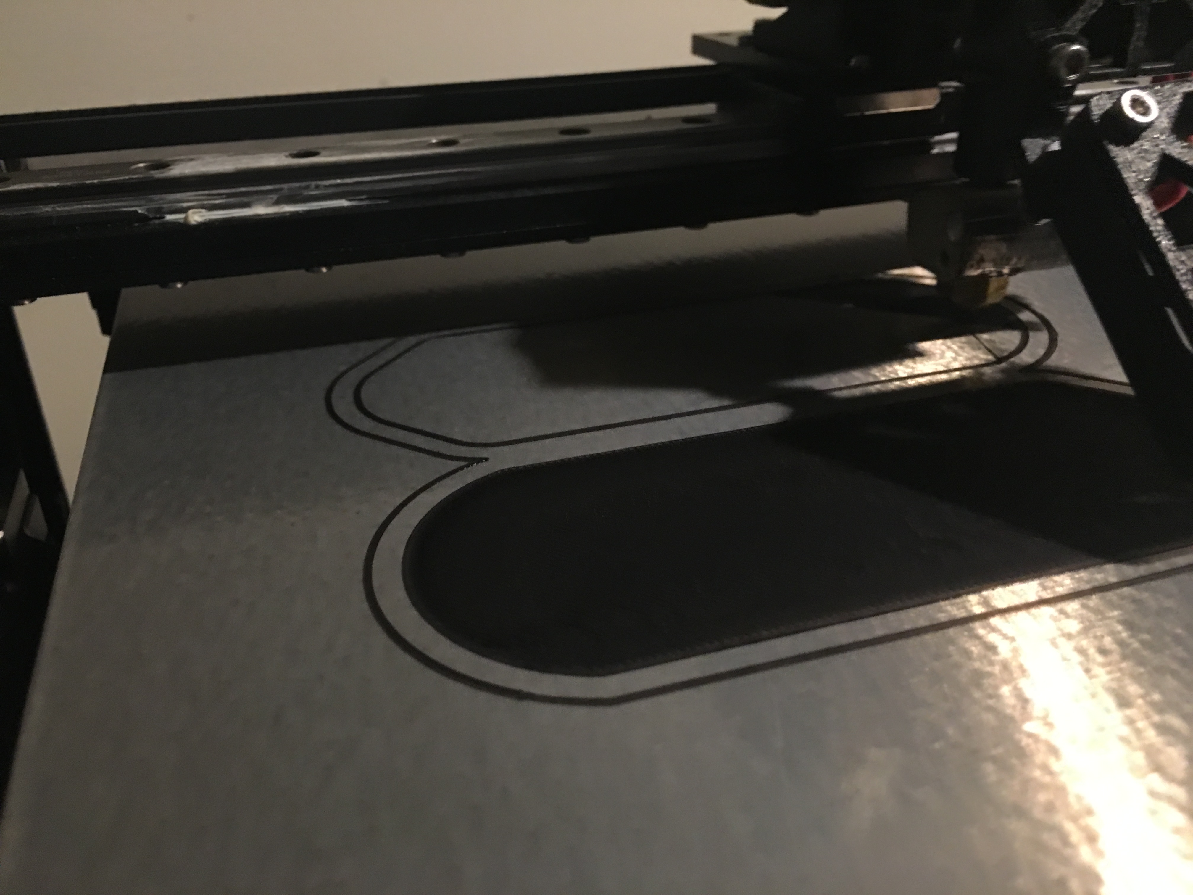

- It works? Seriously though no lifts.
- It lets me run the heated bed cooler cuz metal = better heat transfer and whatever the coating is on it makes less heat required
- It lets me also run the extruder cooler because I can raise the nozzle farther away from the bed and thus there's less back pressure. I'm still playing with this - hoping to get down to 200C with my v3b & PLA.
- Once cool, prints just detach, like they would with the glass bed (for the most part - see first con)

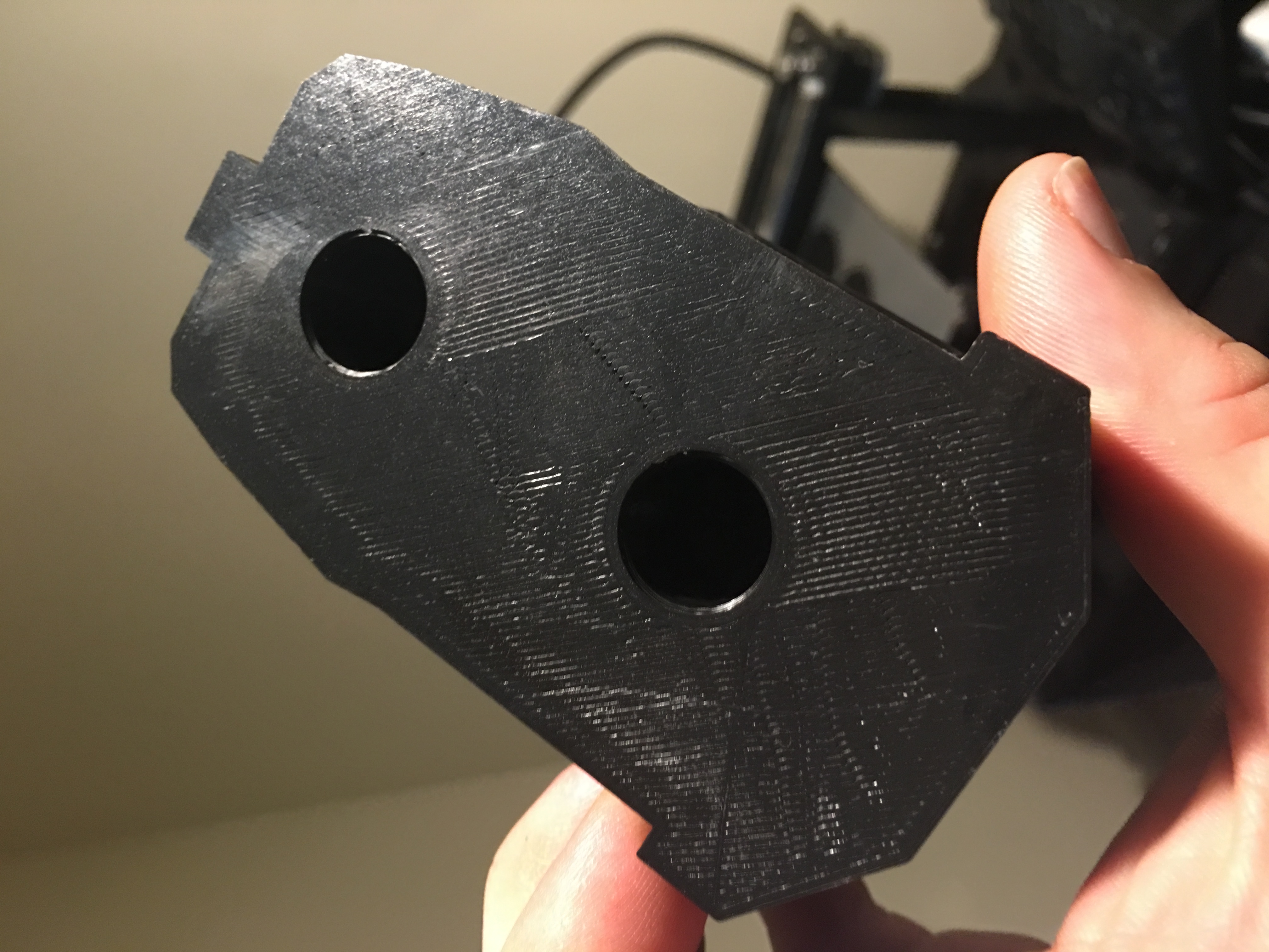

- The finish produced is somewhere between the glass bed shiny and the super matte finish of painters tape.
- No curling with no bed additions = win for me, even with the coating. As long as you treat it with some care it appears to be holding up fine (I've put 3 big prints down on it and they've all done really well)
