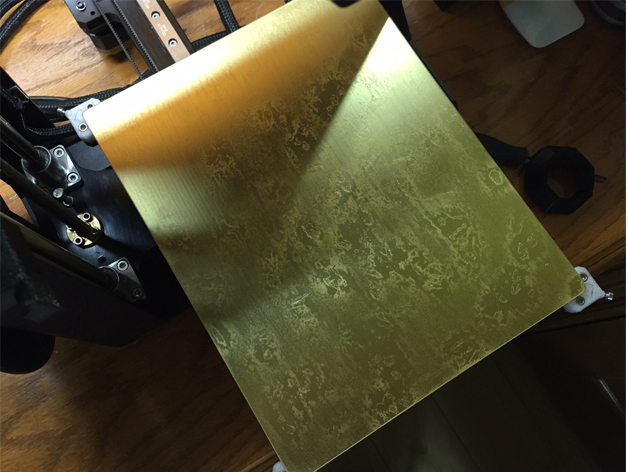

Oh my dear heavens - i have achieved printing nirvana! :D
The components:
The MIC6 tooling plate:
It's flat. It's really, really, really flat. I can actually touch the nozzle to the bed, move it to every single point on the plate, and the nozzle does not shift by one one-thousandth of a millimeter. :shock:
And the heat goes aaaaall the way out to the edges of the plate. No more prints popping off in the chilly outer corners. :D
PEI surface:
FTW! Attached with the 3M full sheet tape to the non-beaded side of the MIC6 so that no adhesive is needed. Picture of the ugly result below, but man-oh-man, does it ever deliver!
Those of you with the plates, give the 0.03" PEI a try on it! :D

Jules, have you tried with PC-Plus?

No, I don't have any yet. (Gonna order some after tax time.) :cry:

Well, I wish I'd tried it sooner. (And I thought I had a pretty level glass, all things considered. :| ) But what a difference. It's night and day.

Hey Jules, I see .003" PEI on McMaster but not .03". Did you use .003"?
