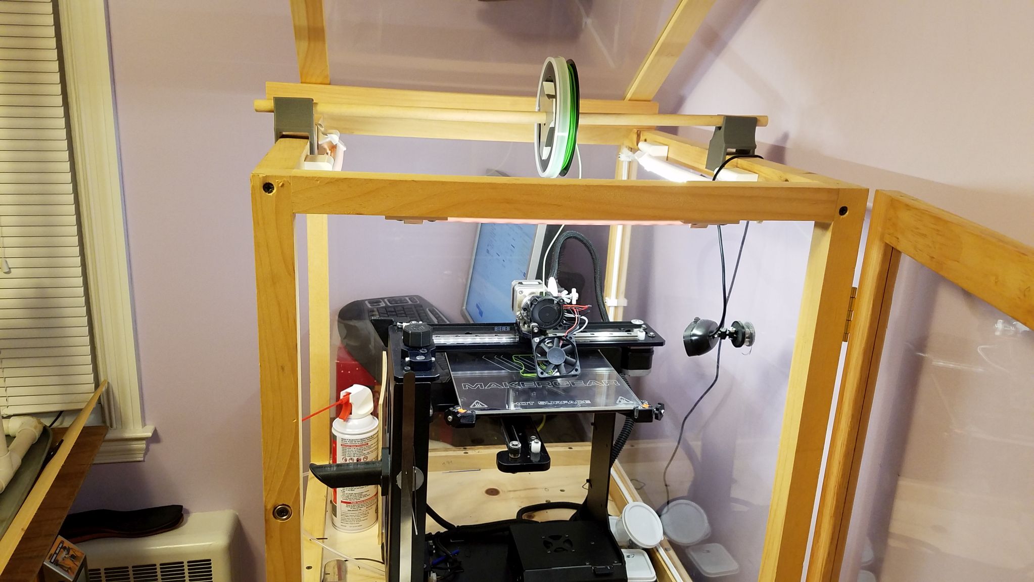

This drive is on thingivers and I have used it for a while now. With careful tension adjustment and gravity feed spool holder and a larger nozzle it can do TPU

Sorry, meant to attach the factory file, but let me fine the stl and the factory.. had to zip them to attach These should print with ABS no problem if if you have simplified 3d to import them. Tension adjust is still very sensitive and a gravity feed setup for is kind of a must.
No matter what you will need a 1.75mm drill bit or 2mm to make sure the passage is clear. The one I printed a couple weeks ago with the .5 mm nozzle only needed a 1.75 passed through by hand to remove a nib or 2. Others in the past I have printed I used a 2mm but I prefer the path as snug as possible.

Gravity feed.. have inserts for the larger spools with bearing to allow very easy movement of the spool
