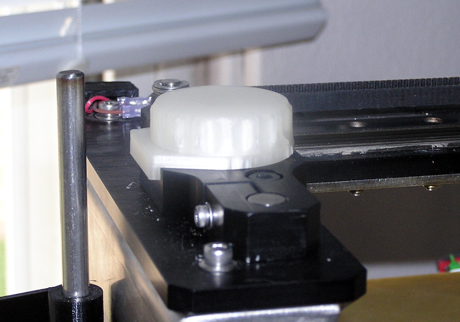

I have made a break for the z-axis on the M2 . It uses magnets to create a slip clutch that stops the z-axis from falling when done with a print.
Design files and instructions:
http://www.thingiverse.com/thing:1577463
Feedback welcome.

Where was this last year when I first got my machine? (Whacked the living daylights out of my Z-motor more times than I could count!)

It didnt seem real bad until I added the mic6 plate.
It was falling too fast.

Using magnets to counterbalance the weight of the Z-stage. . . how can I not like it? Great design.
