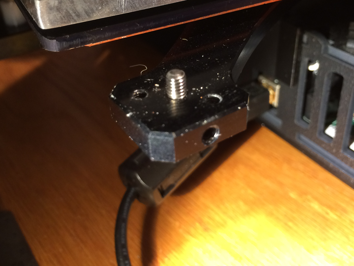

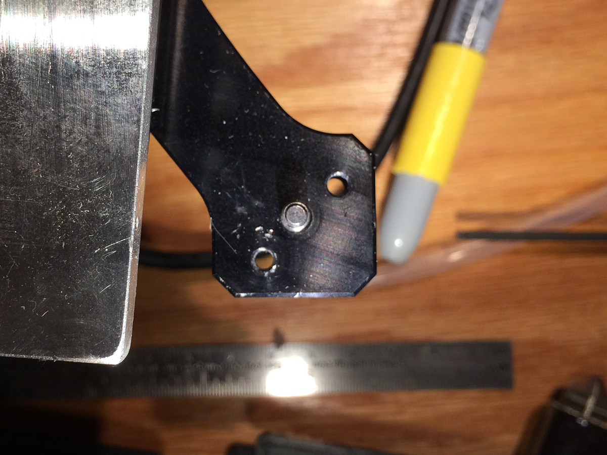

As someone mentioned several post above I don't see why the same end result cannot be achieved by removing the springs and replacing them with a couple of washers. The existing spider can then be drilled and tapped on each corner for the new leveling screws. I'm willing to try this but would like to see a good close up picture of where the screw comes through and touches the heater plate. From the video it appears to be very close to the corner. Is the corner of the heater pad trimmed back so the screw touches the aluminum heater plate?

Yes... the heater pad corners are trimmed back so the screw touches the aluminum heater plate directly.
There is also a setscrew in the side of the plate that holds the level screw from backing out. (this might be harder to do unless you have a full size drill press.)

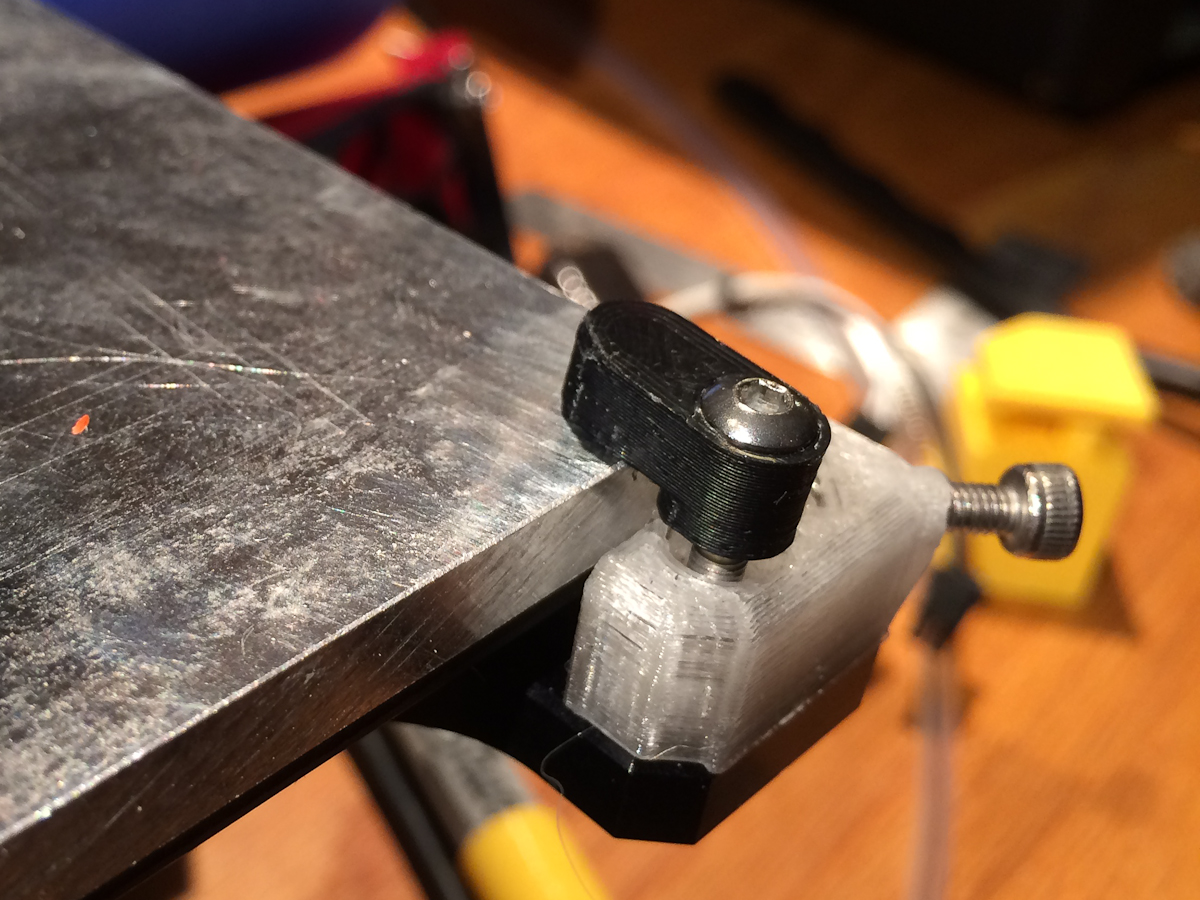

The hold down for the build surface. (I use Jim's printed corners in conjunction with the stock Rev. E hold downs because my heater plate doesn't sit flat even with the Mic6 plate on it.)

Drilling and tapping the level screws should be easy enough with a drill press... here's a close up of where they are. (corners are removed) Yes... the heater pad corners are trimmed back so the screw touches the aluminum heater plate directly.

on a side note, if anyone is looking for the corners, there is a special one i made specifically for rev3 and beta testers. it does not have the pad on the bottom.

Thanks the pictures were exactly what I was looking for. McMaster sells Nylon tipped set screws which should work well for the side locking screws.
