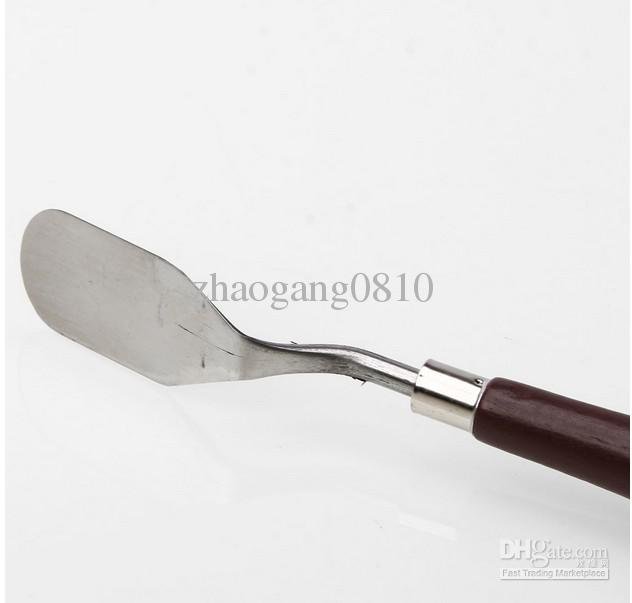

I use a pallet knife that I picked up for a couple bucks at a local hobby shop.
Its not sharp at all, so I don't feel like it could scratch my PEI bed.
I'm too impatient and would probably scratch up the bed using that knife.
