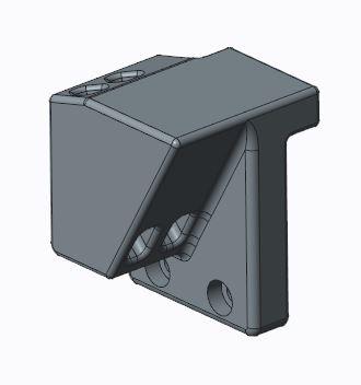

I run both filaments from the left side through this block. STL is attached.
m2-x-endstop-wire-cover4.stl
(710.82 KiB) Downloaded 748 times
