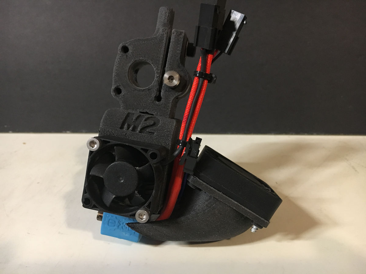

Indeed it is Jim; very much inspired by your design. I was initially going to print and use yours but wanted to "tinker" with it a bit. One thing led to another and before I knew it I had spent far more time making modifications than I had planned. Is the photo of the printed part made with carbon-filled material?
Re: Bed Fan Duct
Post by jimc » Sat Oct 15, 2016 5:19 pm
Yes thats the esun carbon filled nylon

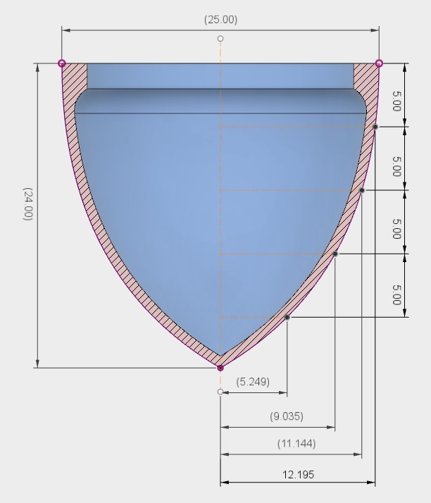

zemlin wrote:Nice looking rig, and interesting analysis. I'll try the cone thing on my duct setup.
Thanks zemlin. A cone should make an improvement to any ducted fan arrangement. It occurs to me that a cone might also be beneficial for non-ducted bed fans as well. Air passing over the surface of the cone will tend to "stick" to it, following its curvature and being bent toward the flow axis due to conanda effect. This would tend to improve airflow and should also have the added benefit of concentrating or focusing the stream nearer the flow axis. This effect would be reduced when the tip of the cone was near the print bed but as part height increases it would likely prove beneficial. Would likely want to use a cone with more of an acorn shape for non-ducted applications. I have not tested or analyzed this shape but offer it as a reasonable place to begin testing.
General profile of cone for fan without duct

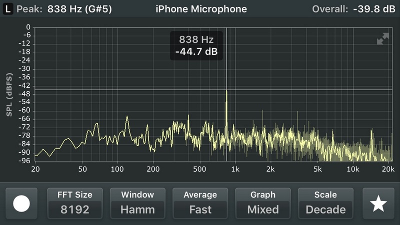

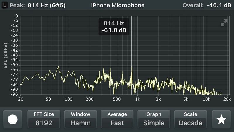

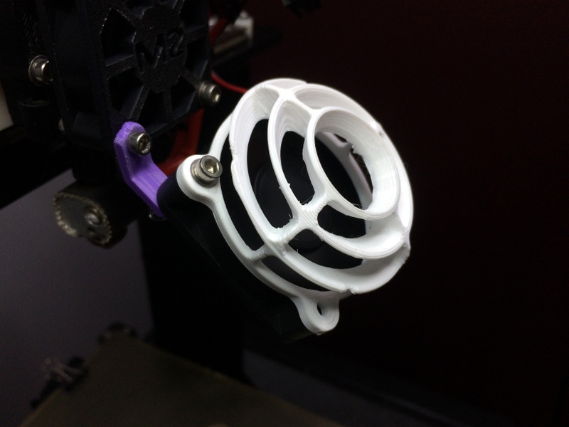

Printed the 50mm fan guard. Successfully reduced ambient noise. Measurements taken at 100% speed set point. Calculate rpm to be around 7k rpm.
50mm fan guard
SPL with stock fan guard
SPL with new fan guard
thunderbt3
Posts: 104
Re: Bed Fan Duct
Post by thunderbt3 » Thu Nov 03, 2016 1:15 pm
Would it be possible to make a noise measurement with no fan guard for comparison purposes?
