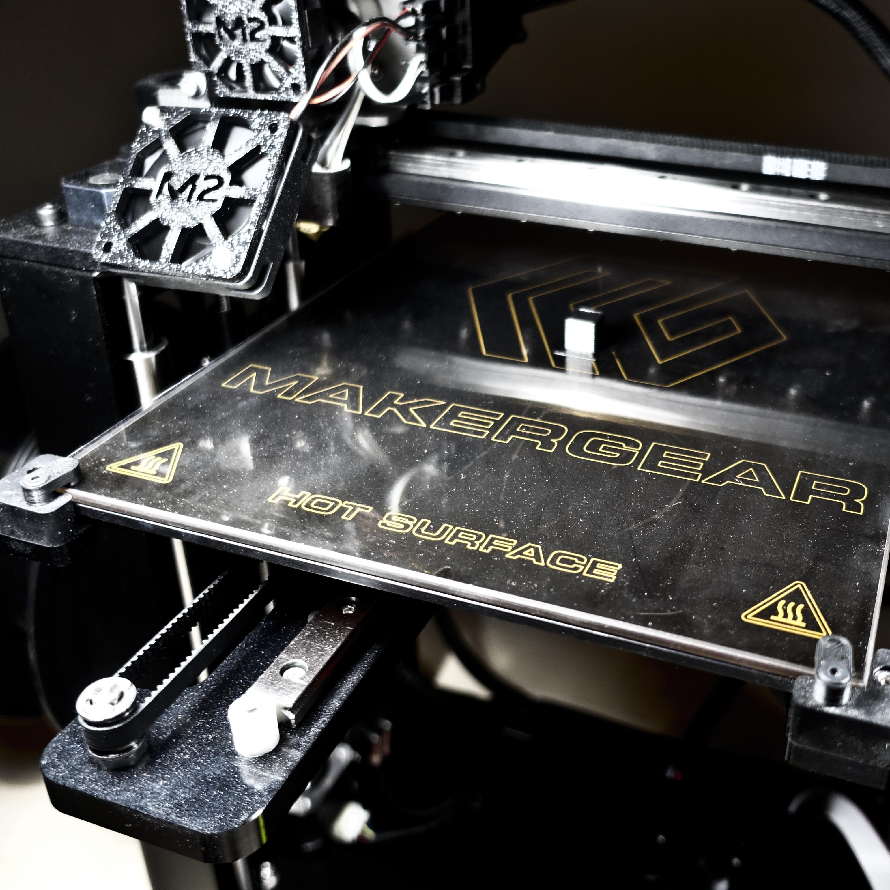

Setup:
Setup

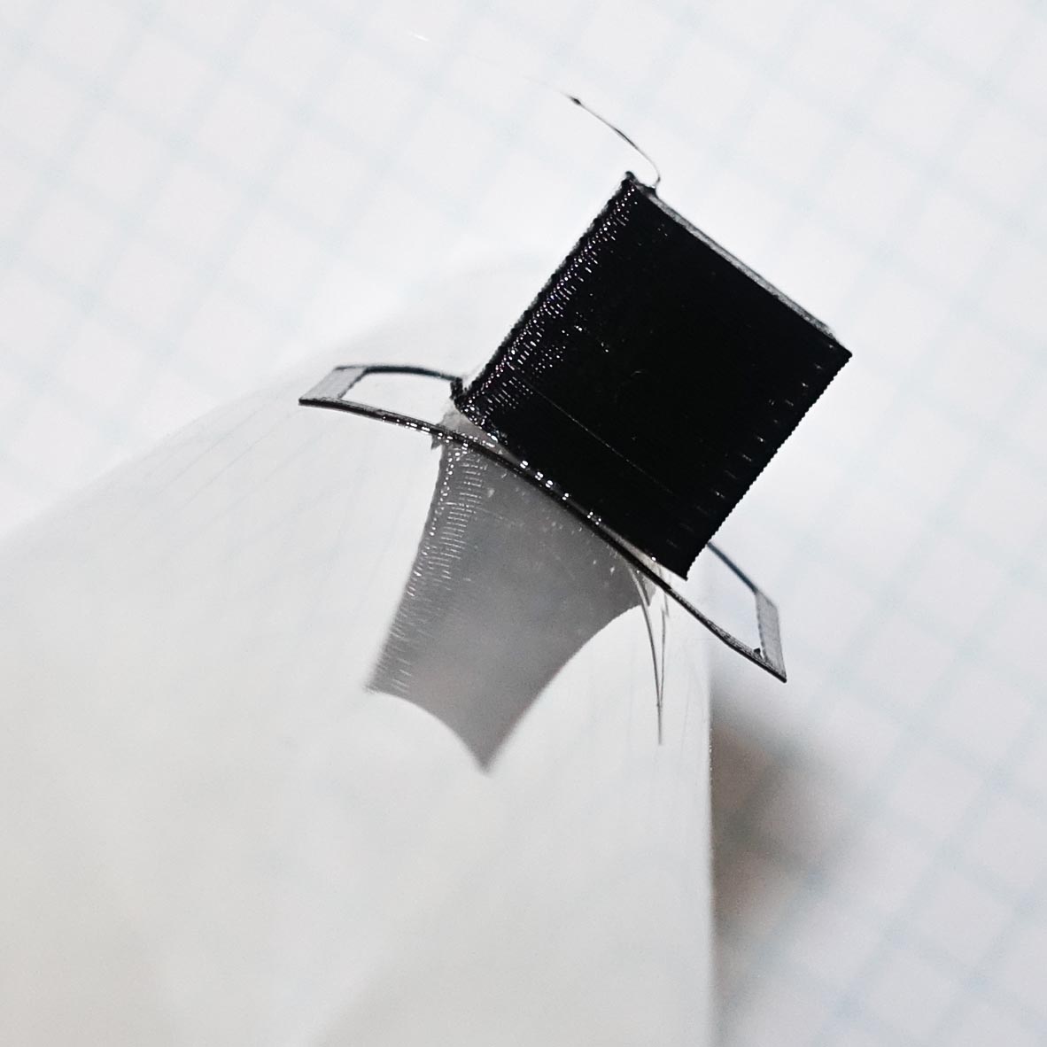

The film can be bended while the cube stays in place (r~1cm):
Bend_Film

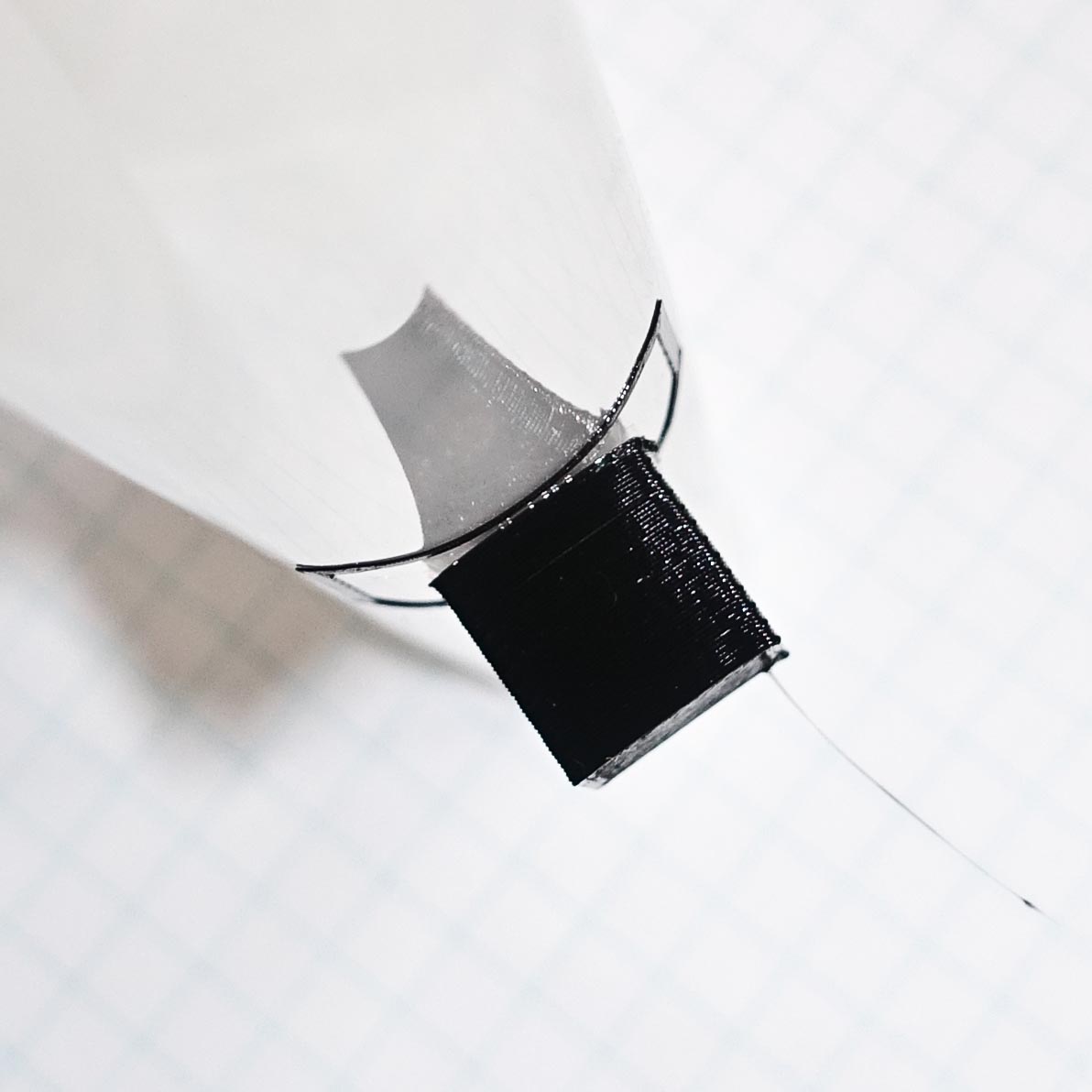

After bending further than, that the cube came off easily:
cube_comes_off

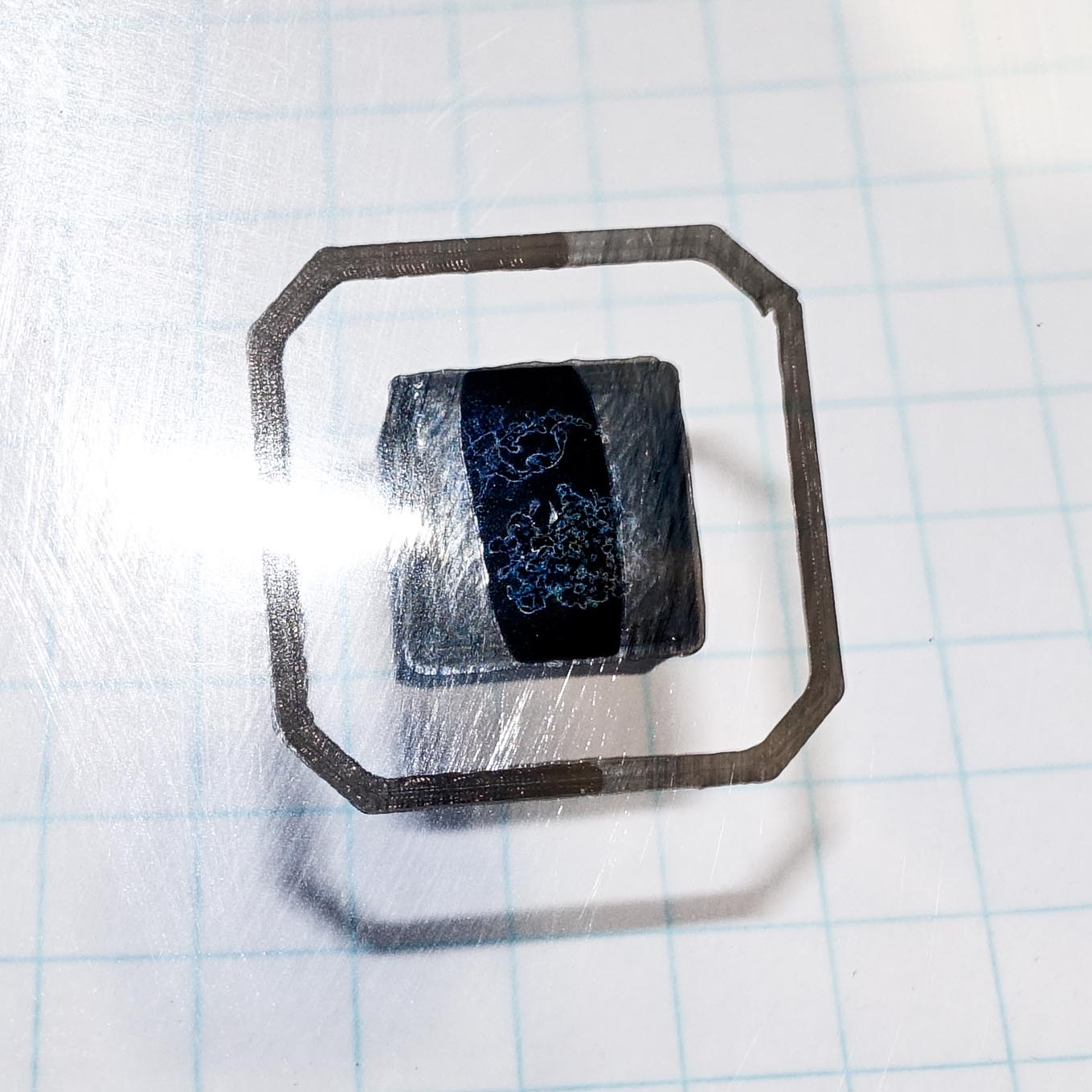

Bottom surface quality was ok (smoother than my Kapton prints):
surface
View from below after bending:
bottom
